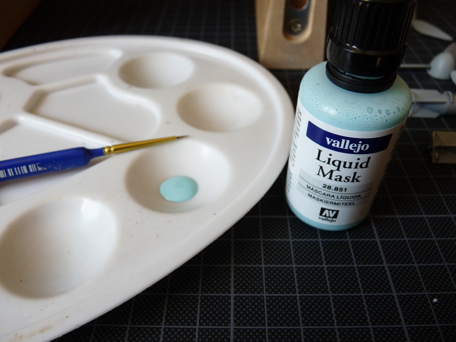

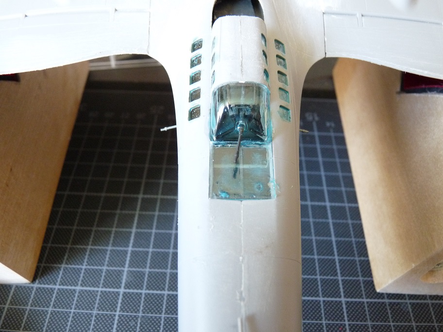

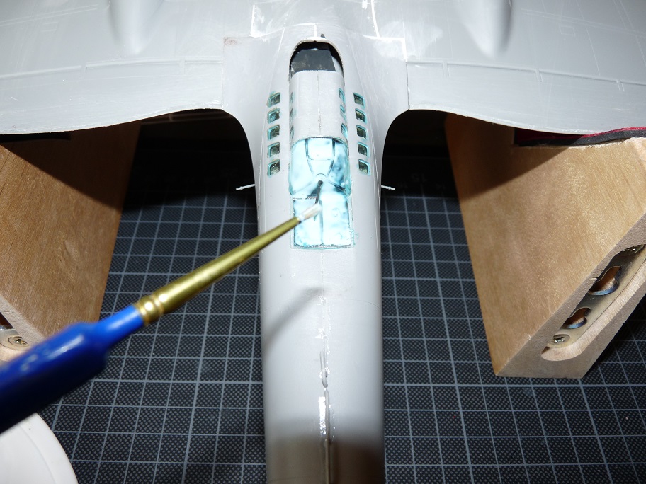

Liquid mask is applied with a brush. It´s a fluid latex/water mix that can be brushed away very easily after the paint job is done.
As you can see the fluid becomes clear when drying.

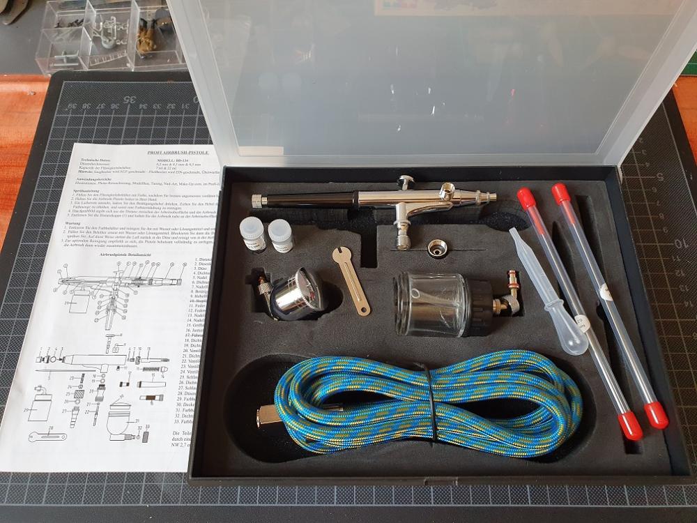

While we´re one it I would like to talk a little bit about airbrushing now. Maybe there are some modelers out there who didn´t try airbrushing for different reasons yet. The next posts are especially for you! So what did I do? I bought exactly the same "Professional Airbrush Set" (which is in fact a starter set) that I bought several years ago when I started using airbrush. The whole set with "double action" spray gun and 3 different (0,2, 0,3 and 0,5 mm) nozzle/needle sets was about US$ 30.

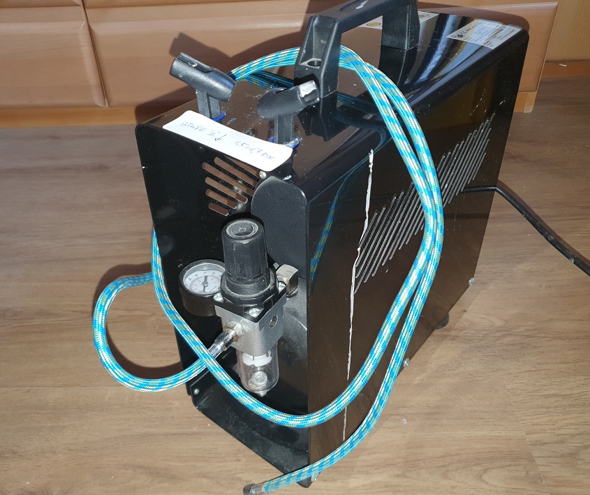

The next thing you need is a compressor. Air pressure should be adjustable (we do need an air pressure of 1,5 - 1,7 bar for airbrushing) and it should have a water separator. I bought mine for about US$ 50 some years ago.

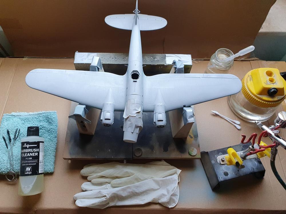

So that´s my airbrush workstation. Base, holder for the spray gun, water, airbrush cleaner, small brushes, gloves and a cloth, that´s it.

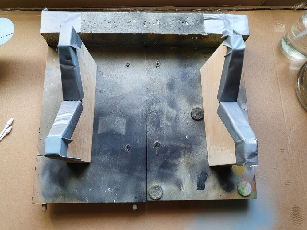

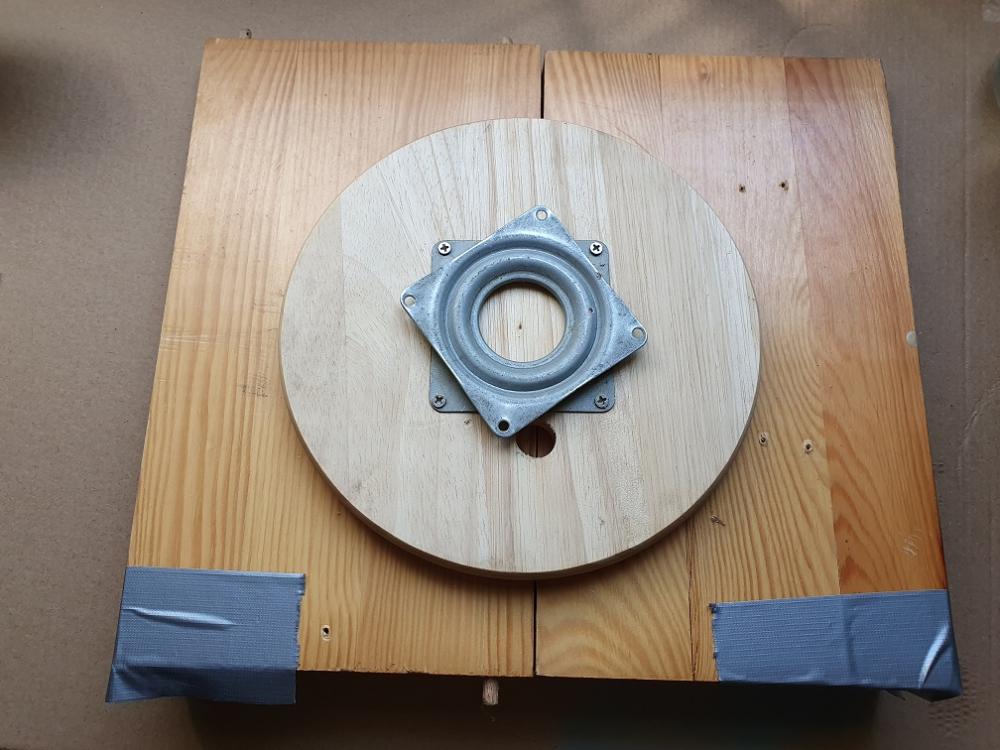

A turnable base for the kit is very usefull. They are availabe online for airbrushing especially, mine is self-built.

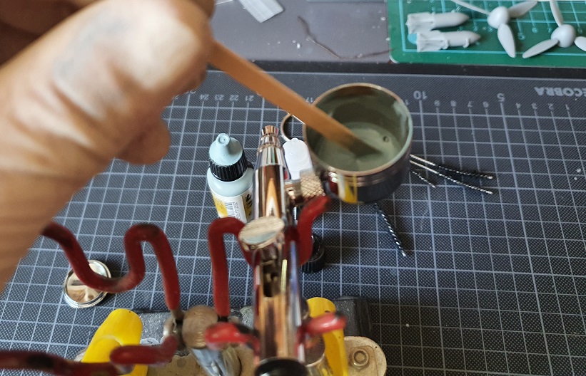

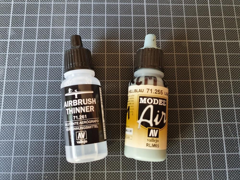

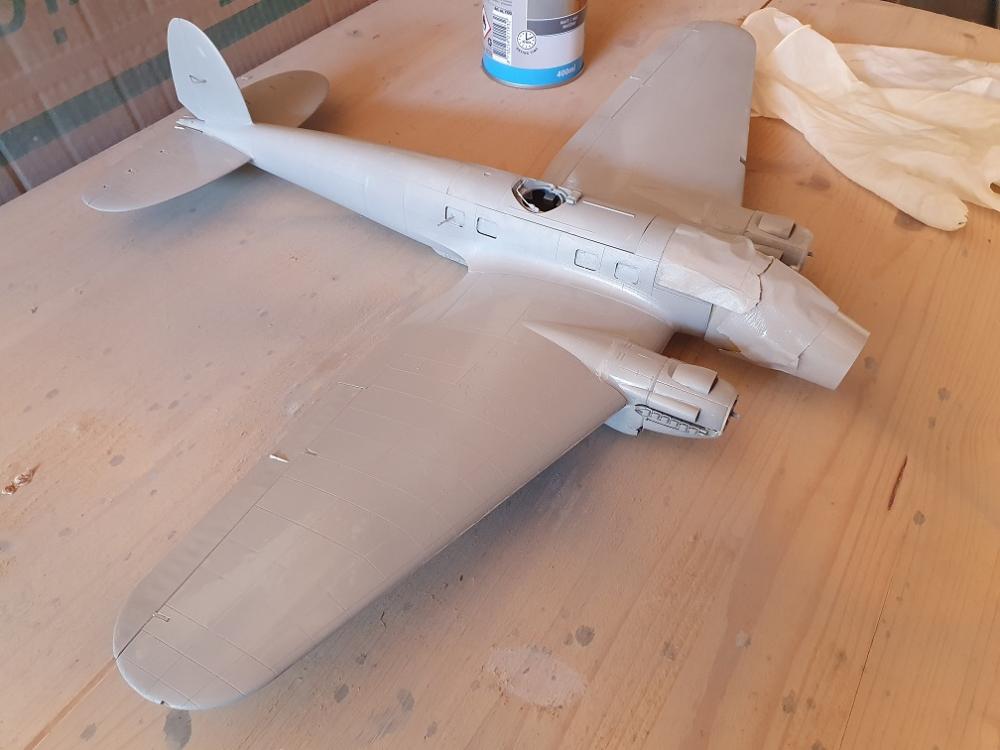

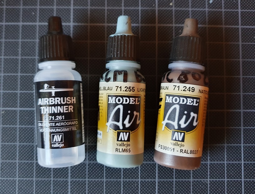

Colors, I`m using acrylics from Vallejo, MIG or Tamiya. Acrylics can be mixed with water and airbrushed very easily. They dry very very fast. Once the are dry, they are water-resistant. For the bottom of the Heinkel I´m using Vallejo light blue "Air" color (RLM 65). I add a few drops airbrush thinner. The airbrush color mix should have the texture of milk

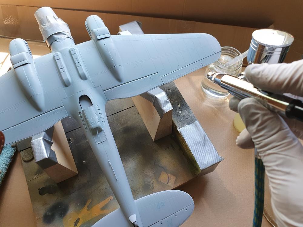

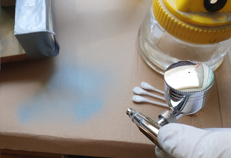

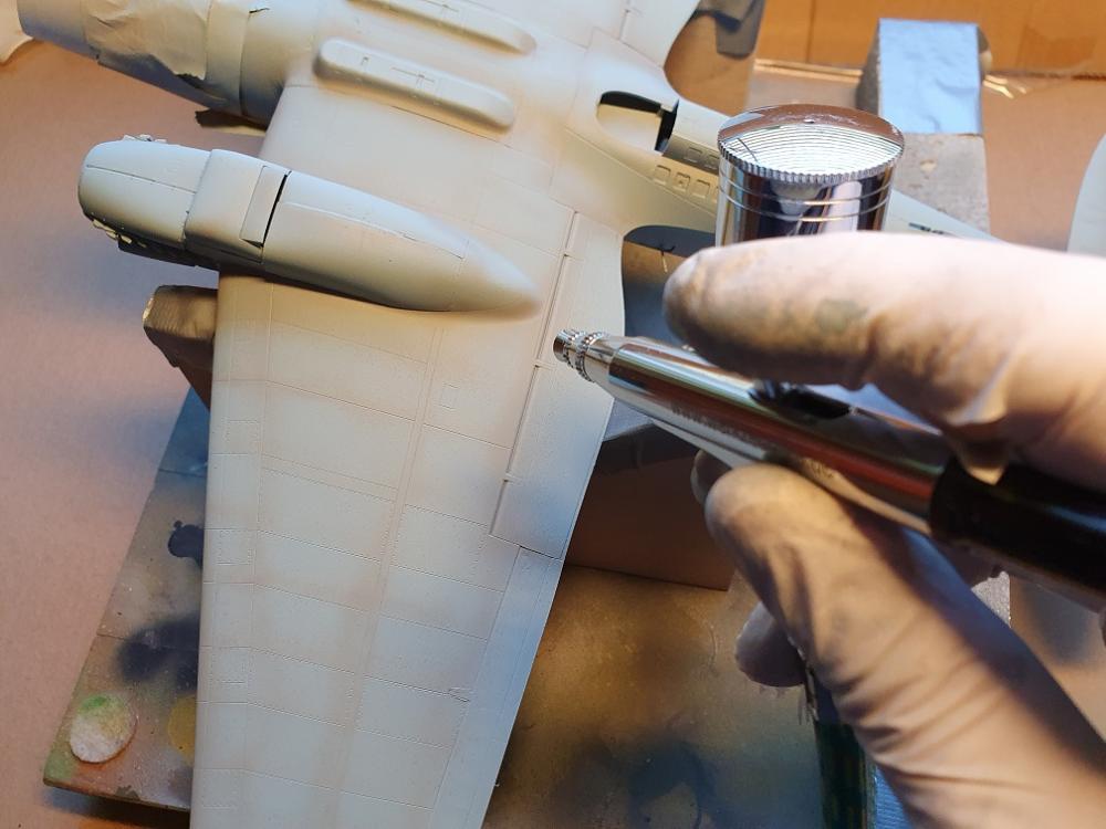

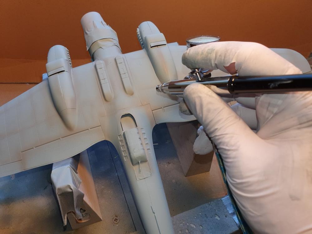

Here we go. This airbrush spray gun was never used before. It works perfectly. I`m using the 0,3 mm nozzle/needle set applying several thin layers of color keeping a distance of about 10 cm to the kit.
OF COURSE if you are using an airbrush the first time I recommend to start practice with paper or an old kit etc.

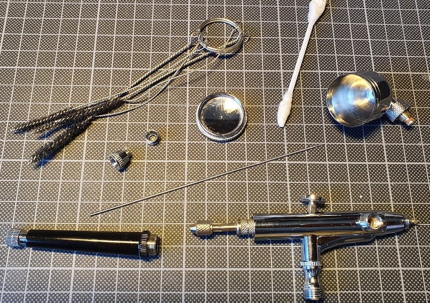

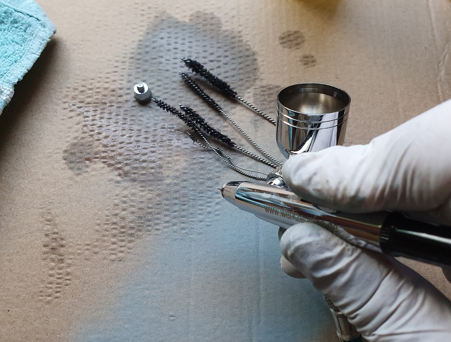

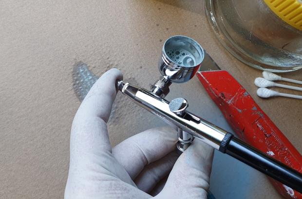

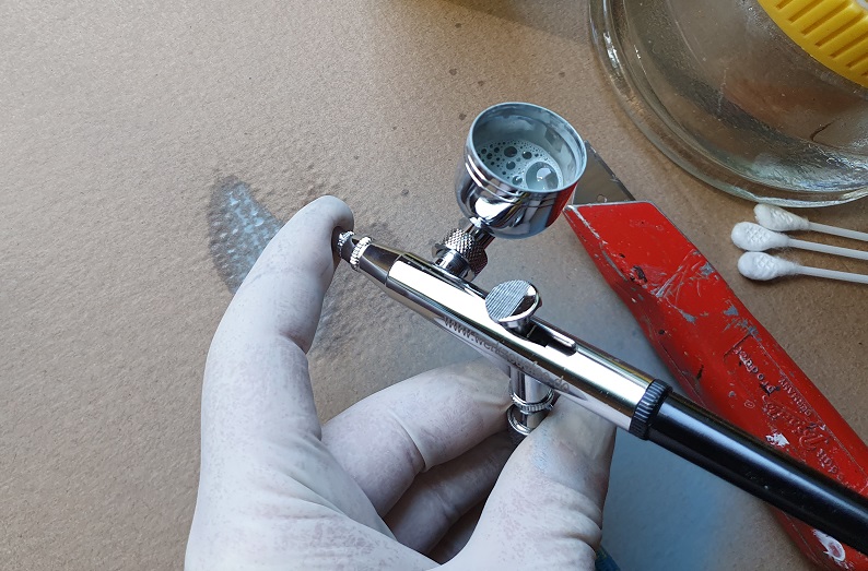

After you have finished airbrushing you should clean your spray gun AT ONCE, because, as mentioned before, acrylics dry very fast. I`m using airbrush cleaner, Q-tips and very small brushes.
First spray all color off the gun.

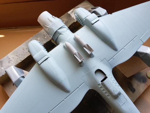

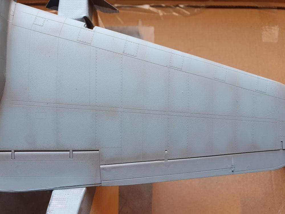

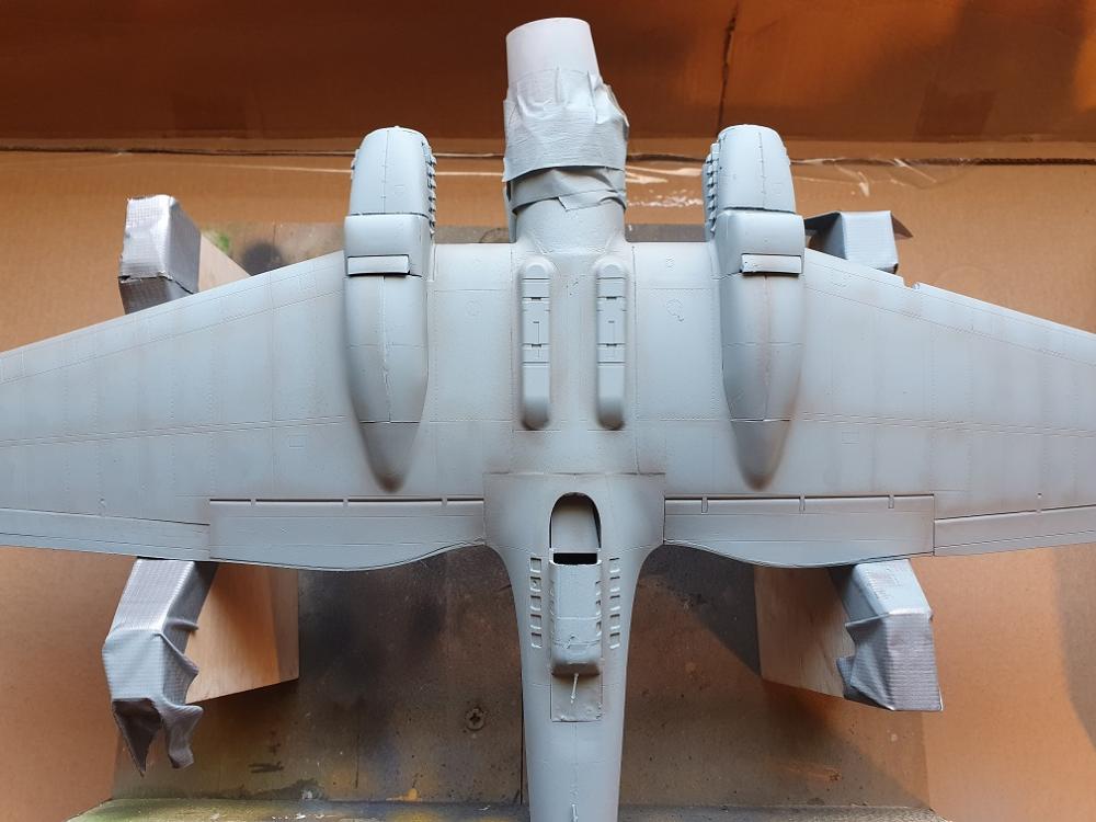

Mono-color areas tend to look monotonous and unrealistic. I would like to add one more airbrush technique totay - shading. The idea is to airbrush panel lines etc. with a slightly darker color to highlight larger areas of the surface. So I´m using the 0,2 mm nozzle/needle set with the gun. I also use the same light blue color and add some drops brown color.
Link to comment
Share on other sites
Proud Kraut

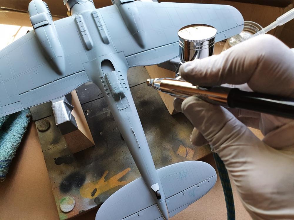

You can also pre-shade these panel lines after applying the primer. In this case I`m shading the panel lines afterwards.

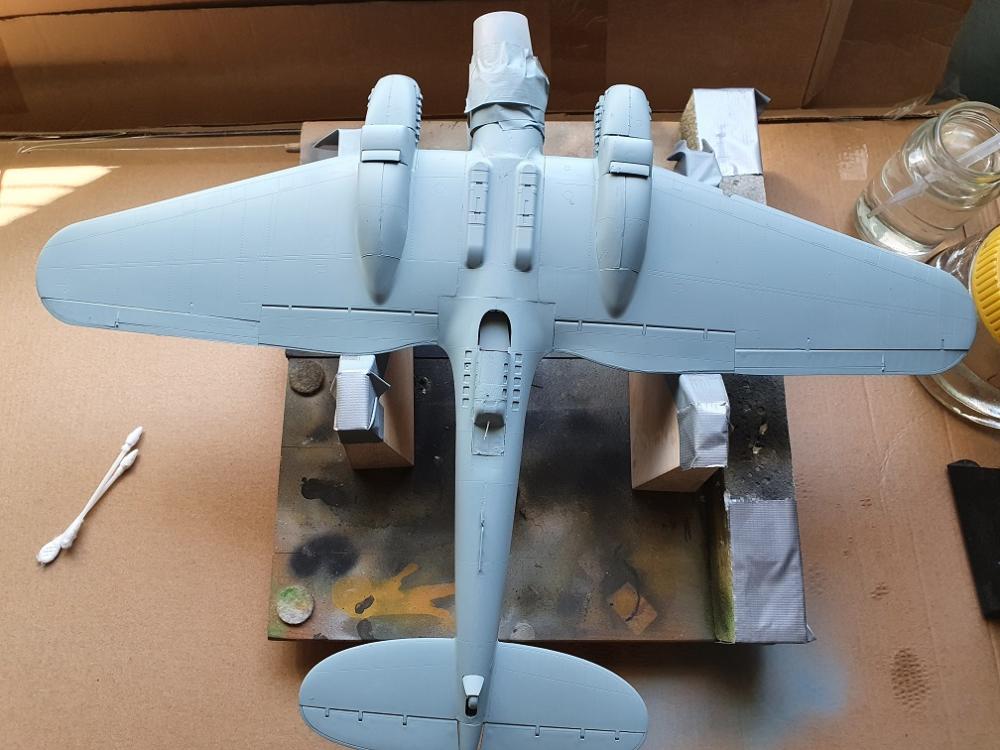

If something goes wrong you can correct the mistake easily. Just airbrush the larger areas with the original light blue color again. Shading is one of the effects you can achieve with an airbrush very easily. That´s it for today, thanks for looking.

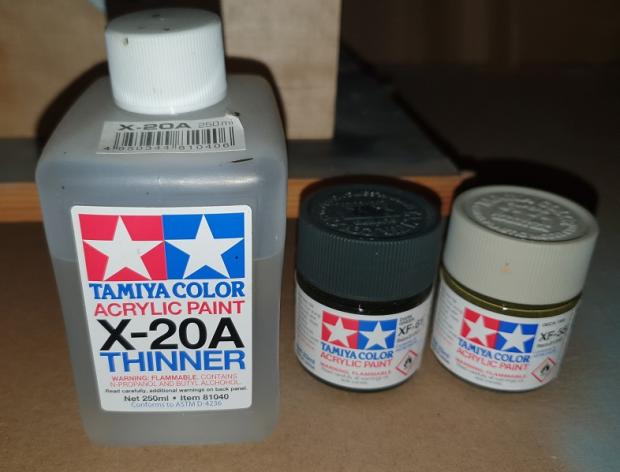

I would just like to add that not all acrylic paints can be thinned with water; Vallejo is water-based indeed but for Tamiya paints for instance you need to use alcohol. All brands sell their own thinners that will always work for them.

@ earlymb: you´re absolute right. E.g. Tamiya acrylics need a special thinner. Concerning your spray gun I know what you are talking about. I bought a more expensive Harder & Steeback gun some years ago and have exactly the same problems you mentioned. Will try that ammonia solution as well, good hint!

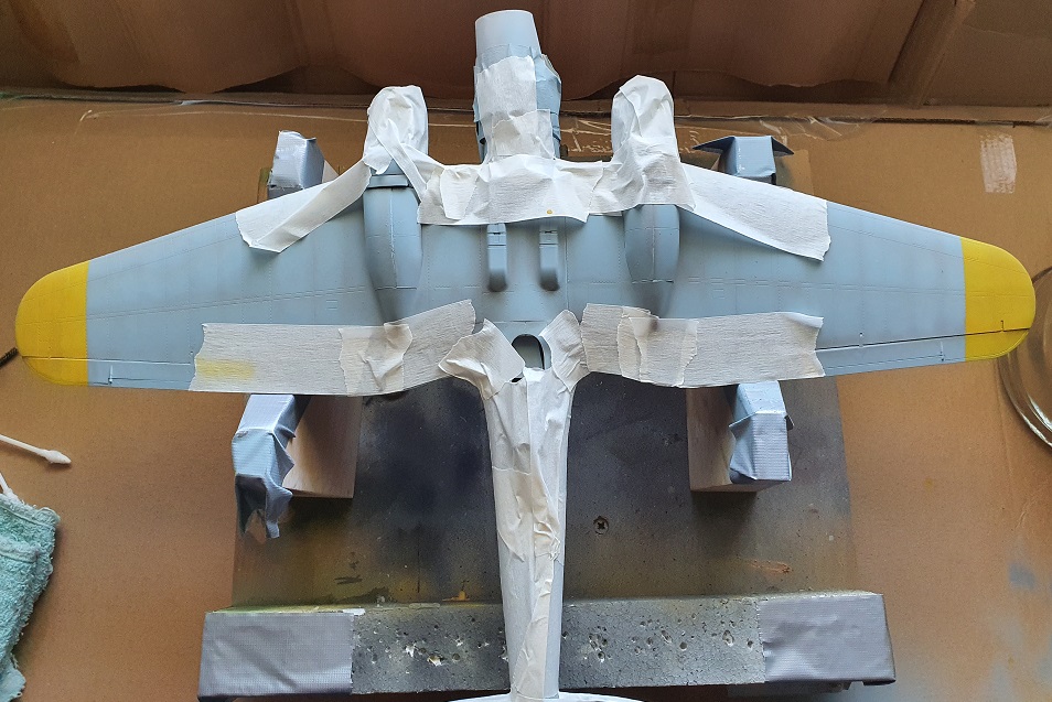

Not much progress today. Some masking and the outer bottom of the wings received their yellow markings.
