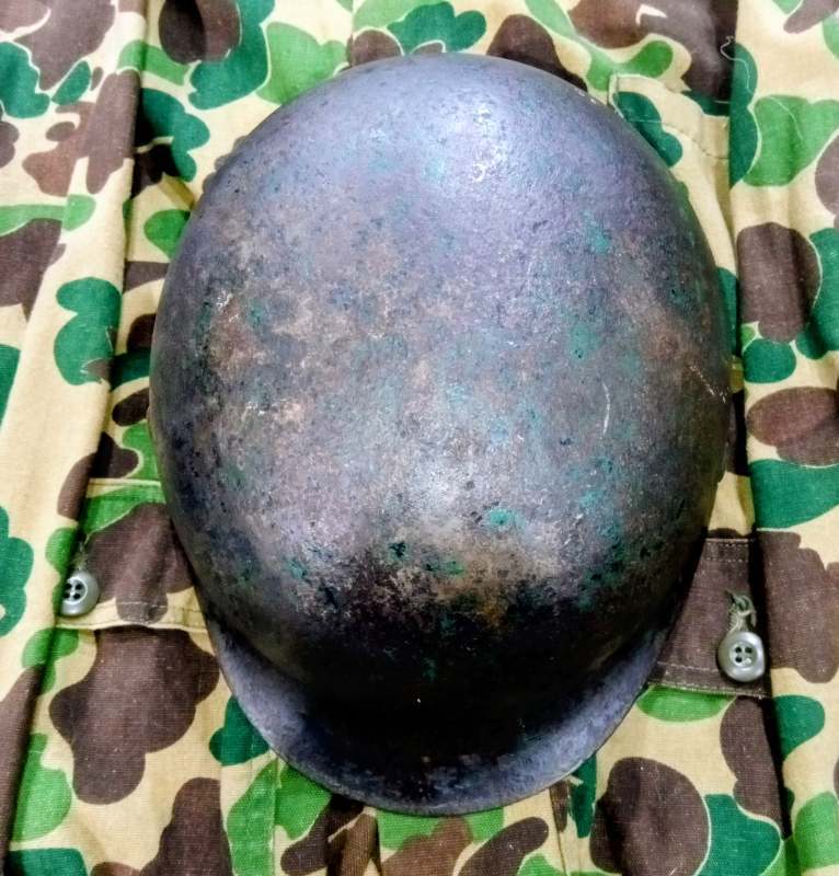

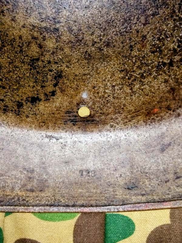

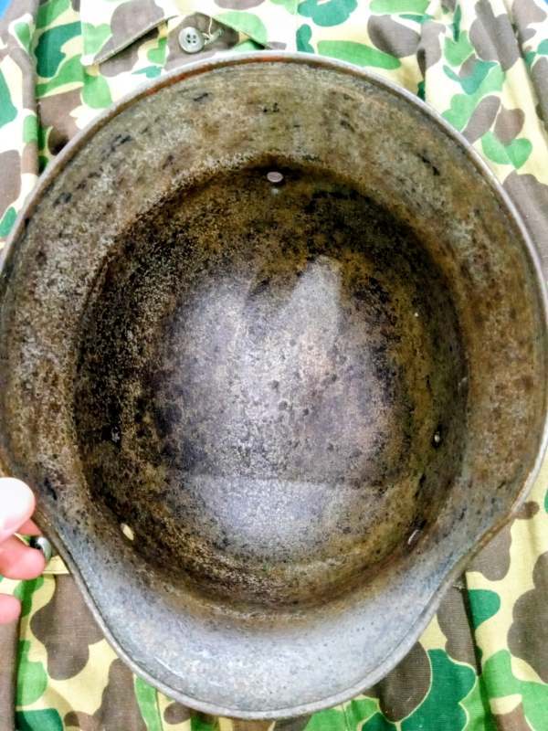

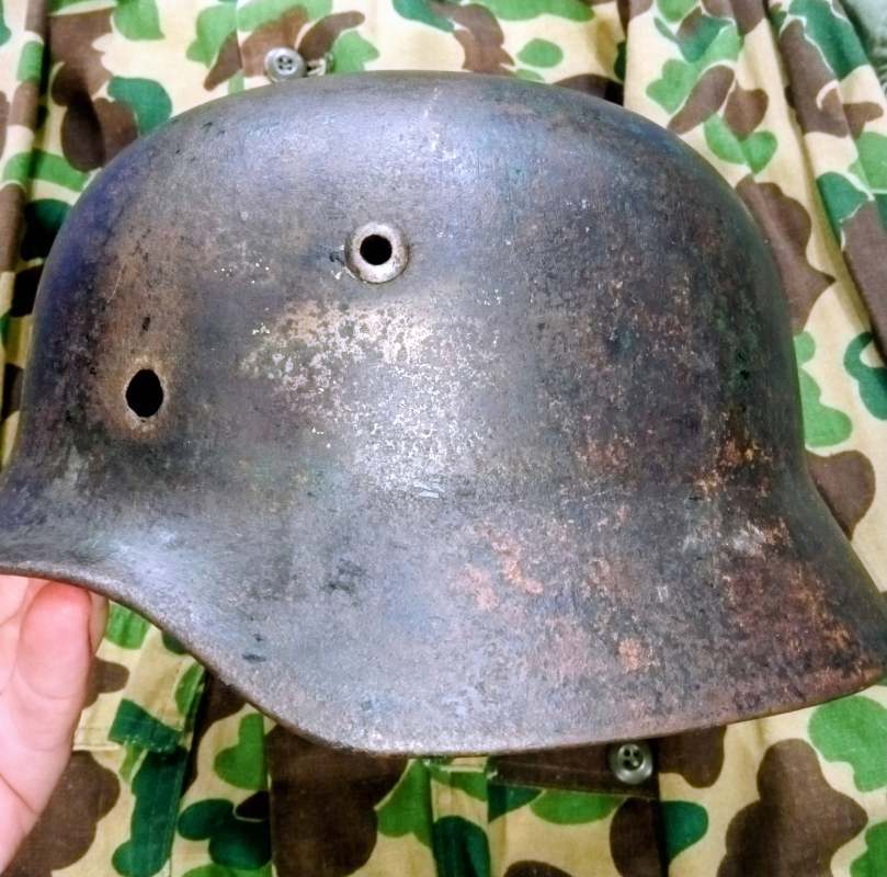

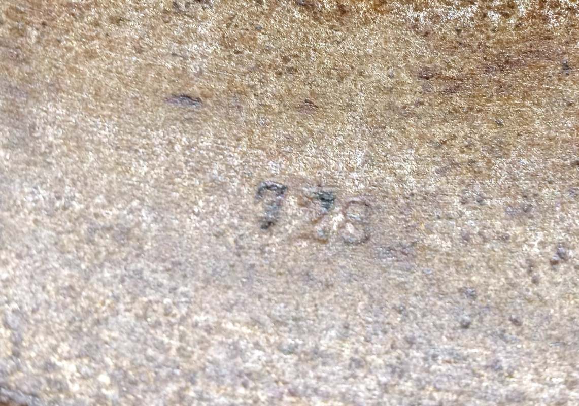

LE LOUP DES MERS Posted September 21, 2025 #1 Posted September 21, 2025 I picked this helmet up on a trade at a gun show today. Did I do good or did I get burnt? The seller I got it from is a trustworthy local German collector so I don't think he'd be lying. He said somebody after the war painting this helmet green then another collector bought it from the guy who painted it. The second guy wanted to take the green paint off and bring the original paint back. However he sanded the helmet down way too much and took the original finish with it. He then sold it to the guy who I did this trade on. The seller told me the number inside the helmet that's usually on the side is completely gone because the second guy sanded the inside of the helmet way too much. However the number on the back is still visible, that number is 728. The guy I got it from said he's almost 100% positive its original. So hopefully I didn't get burned. He recommended I restore it by buying a repro liner and repainting it. He said it would raise the value of the helmet is that true? The original finish on the helmet is basically gone so if I repaint it it's not like I'm ruining the history.

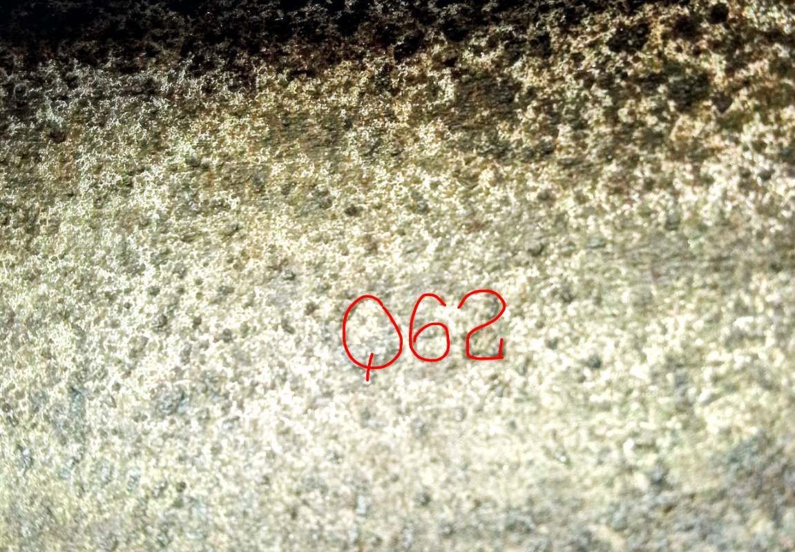

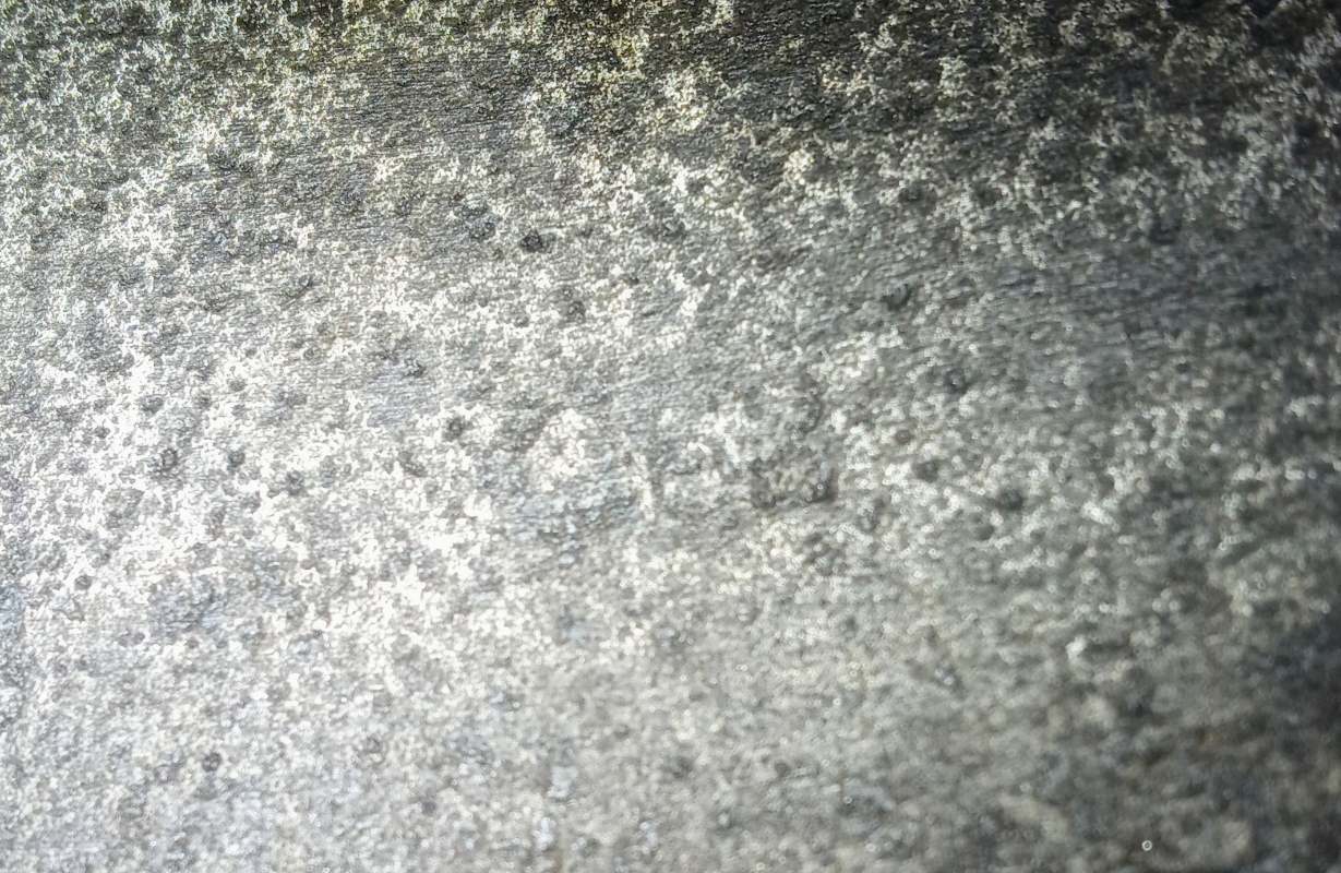

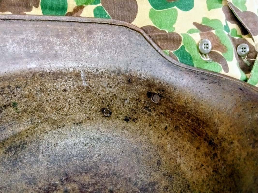

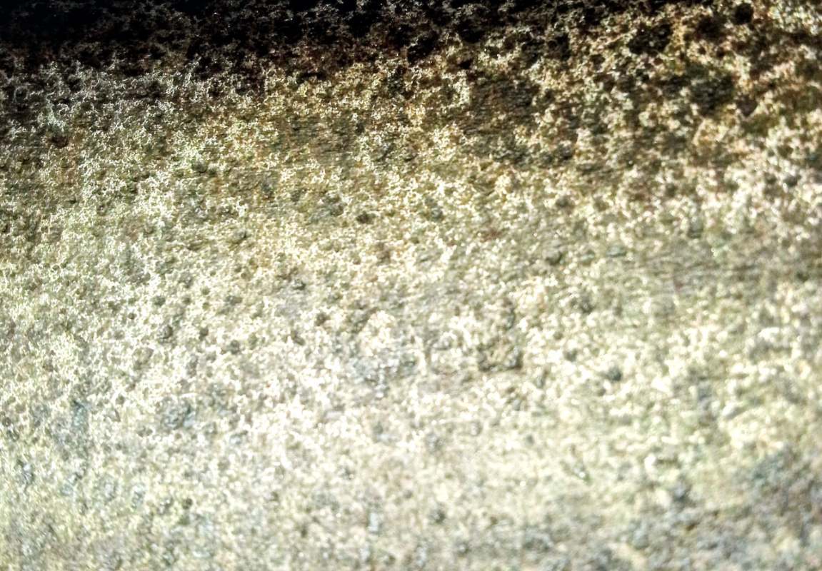

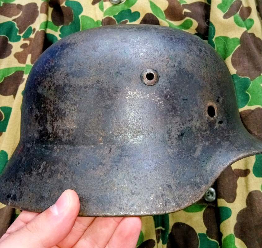

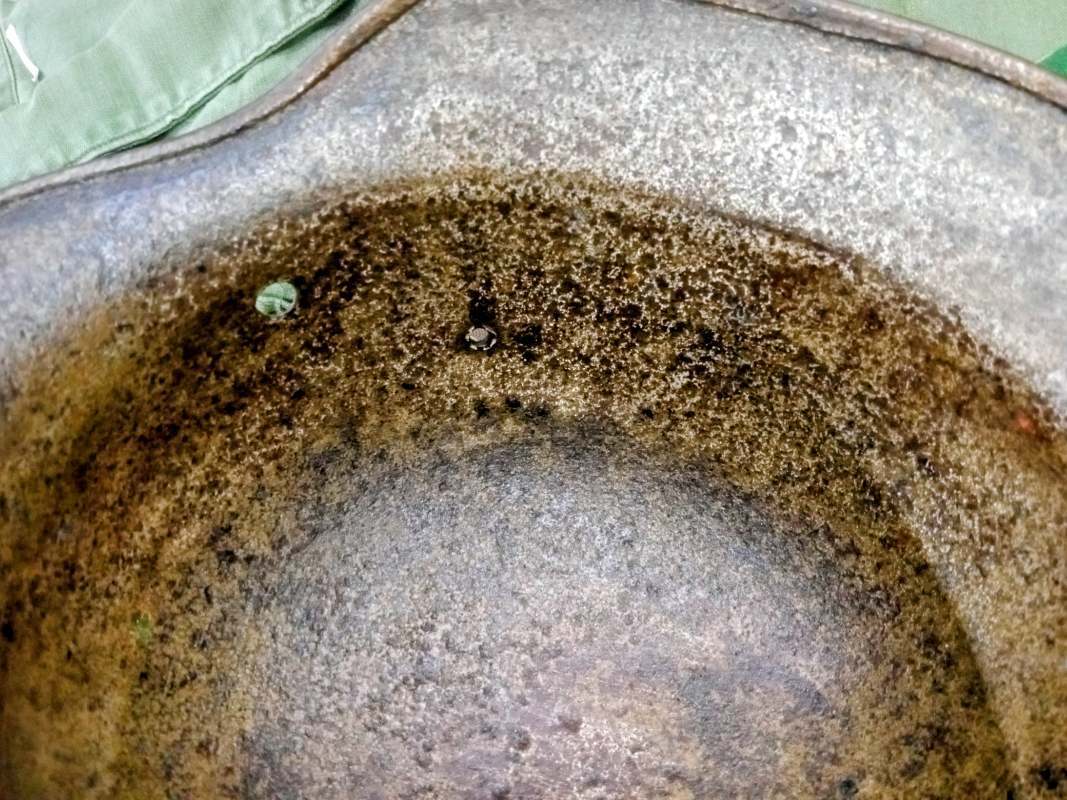

LE LOUP DES MERS Posted September 21, 2025 Author #2 Posted September 21, 2025 Update: ok I took a high powered flashlight and a magnifier to the side of the helmet and good news the marking is not sanded off like the seller said. It's definitely worn out but it's still visible. These are the best photos I was able to take hopefully they are clear enough to see the marking. It appears to be a Q62, I know for sure the number is a 62 I was able to confirm that with the magnifier. The Letter is a little bit harder to tell but it appears to be a Q.
Marshallj Posted September 21, 2025 #3 Posted September 21, 2025 Looks like an original m35. Restoring it does not add value.
Rakkasan187 Posted September 21, 2025 #4 Posted September 21, 2025 The damage and history has already been ruined with this helmet when the first person sanded it and removed all the paint. Repainting and adding a reproduction liner will do nothing to increase its value and years from now if and when you attempt to sell this it may be perceived as an original if restoration efforts are not mentioned. Hopefully your trade item had similar or equal value but in my humble opinion I don't believe you got a fair deal. Sounds like the honest German Collector wanted to part with an item he knew had little to no monetary value... Leigh

LE LOUP DES MERS Posted September 22, 2025 Author #7 Posted September 22, 2025 Is 62 the helmet size? And Q would be the maker?
Rakkasan187 Posted September 22, 2025 #8 Posted September 22, 2025 Q is the maker (Quist) and 62 is the size. To answer your previous question: The value of original untampered with Third Reich helmets are increasing in value and many can't afford or don't want to spend a huge amount of money on a helmet ($800+ in some cases, and with some specific helmets in the thousands of dollars, like SS) so some will chose to buy a reproduction or mixed original shell with repro parts for half the price. Reenactors will also spend the money on a relic/refurbished helmet as to not wear a 100% original when re-enacting. The issues start when helmets that are mixed original and repro are artificially aged to make them look authentic and believable to the unsuspecting. I See it happen all the time and without careful examination and study of the helmets folks get burned all the time. At a recent gun show I witnessed a young man spend close to $1000 dollars on a fake SS helmet. Thought he got a steal and when he brought it to my table to show it to me, I had to break the very bad news to him that the decals were fake, the maker was wrong for SS helmets, the chinstrap was a reproduction, the split pins had been replaced and there were just a bunch of issues. We even went to another well respected and reputable helmet collector and verified my suspicions. He was not able to get his money back and he protested to the manager of the gun show about the seller who claimed ignorance and basically told the manager that "the guy should have done his homework". The manager of the show had banned the individual, little consolation for someone who lost so much money. Prices are very subjective and vary, it all depends on what one wants to spend on a relic helmet, and of course the "provenance" that is attached to it... "Helmet dug up at Stalingrad" is one of the most overused catch phrases to lure someone into buying a relic. I am very skeptical that the vast number of dug up relic helmets were all in the Stalingrad area.... Buy the item not the story as it has been told... As Marshall has indicated, if you are happy with the helmet, enjoy it.. Leigh

Rakkasan187 Posted September 22, 2025 #10 Posted September 22, 2025 You have an M35 Helmet. One of the telltale signs is the rolled edge around the helmet, vs the M42 which has an unflared straight edge aroud the helmet. Leigh

shemp h. Posted September 23, 2025 #14 Posted September 23, 2025 An M40 also has a rolled edge, an M35 has a two piece vent like your lid,an M40 and a M42 have a pressed out vent hole when the shell is being pressed. I looked up your helmet on the helmet data base website and if I read it correctly your helmet falls between 726 Q62 SD Heer re issue with a steel liner and 738 Q64 SD LW re issue aluminum liner. Let some of the helmet guys jump in on this one. I hope this helps. Bill

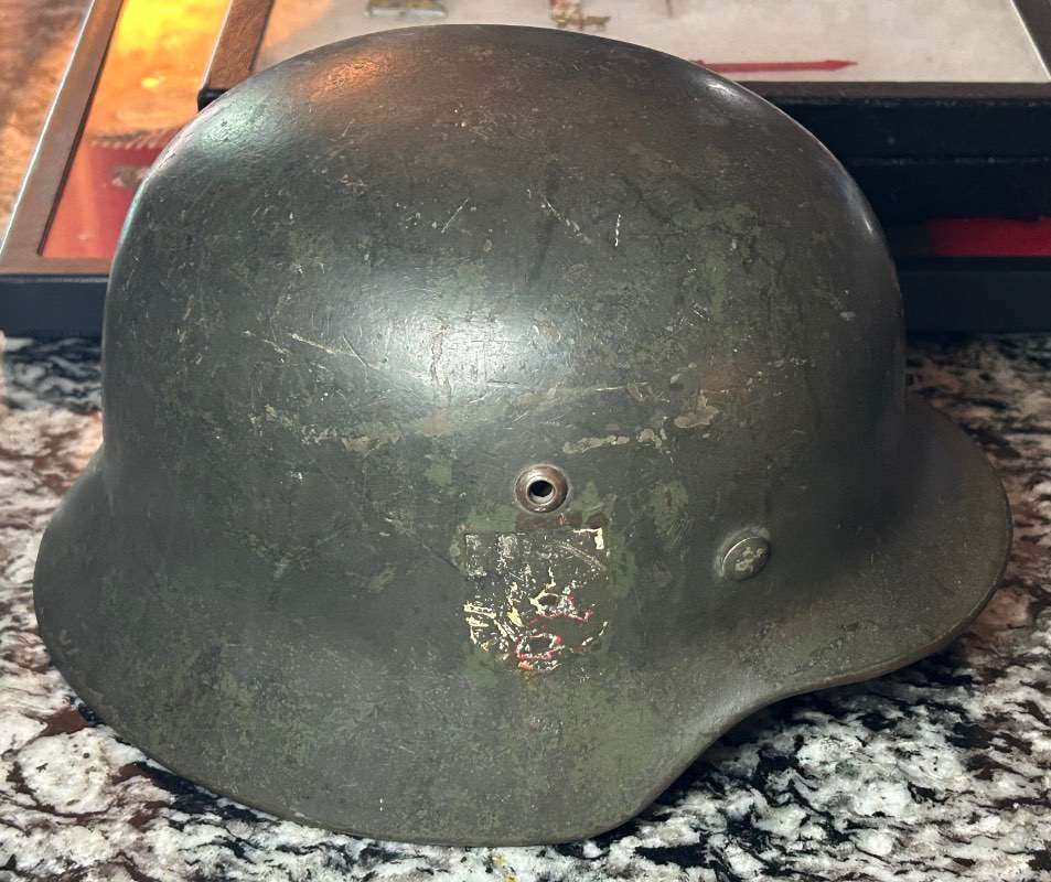

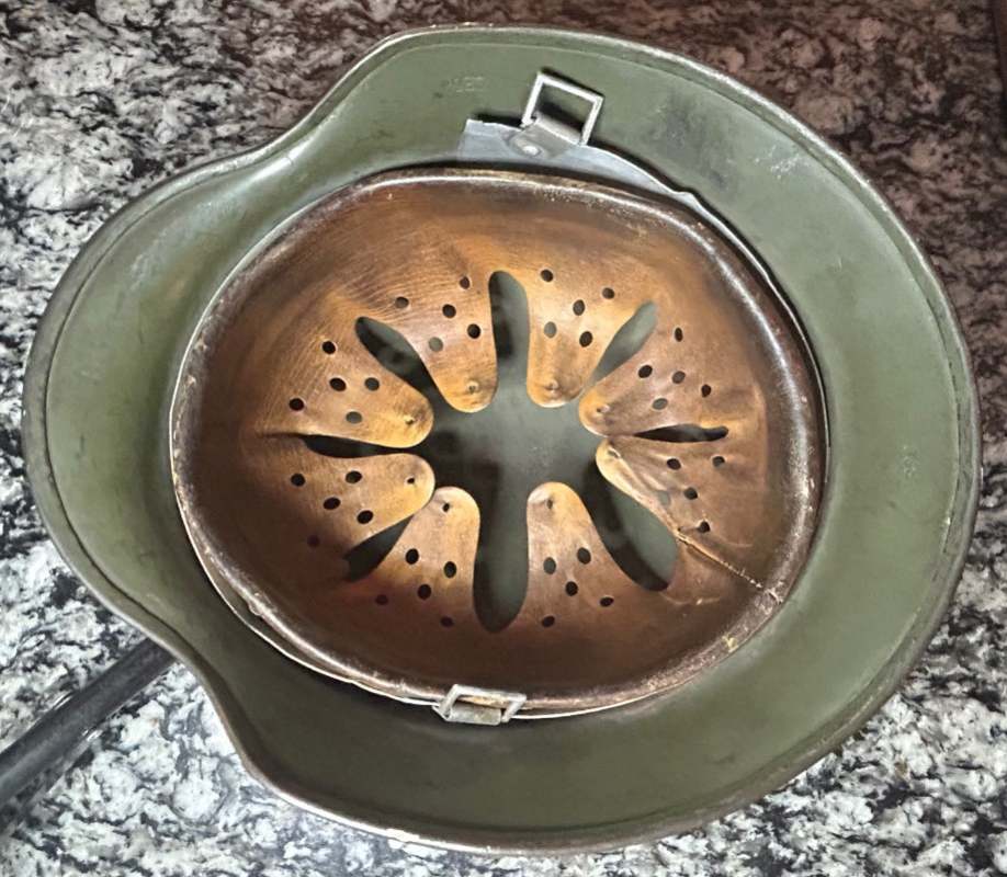

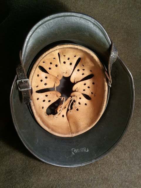

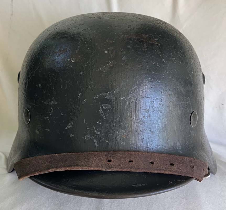

Preppy Picker Posted September 25, 2025 #19 Posted September 25, 2025 Here is an M35 double decal army helmet that has the dark grey paint over the original pea green. Applied in the field.
LE LOUP DES MERS Posted September 25, 2025 Author #20 Posted September 25, 2025 I'm guessing it was a reissue at some point if it's life?
Preppy Picker Posted September 25, 2025 #21 Posted September 25, 2025 45 minutes ago, LE LOUP DES MERS said: I'm guessing it was a reissue at some point if it's life? They painted around the eagle and over the tri color plus it has it’s original liner so I’m not sure if it’s reissued or painted over in the field.

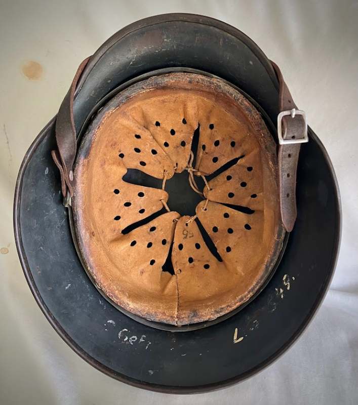

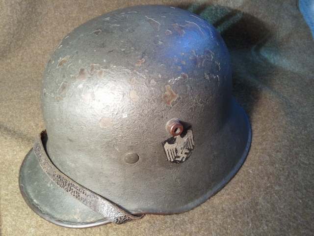

jmd62 Posted September 25, 2025 #22 Posted September 25, 2025 I love those M35 reissued helmets, especially the apparent field repaints. Here's one I have with the thick strokes of repaint.. Several areas of previous whitewash as well throughout the helmet.
shemp h. Posted September 26, 2025 #23 Posted September 26, 2025 On 9/25/2025 at 8:33 AM, Preppy Picker said: Here is an M35 double decal army helmet that has the dark grey paint over the original pea green. Applied in the field. Early liner with the squared D rings, who is the maker?
Preppy Picker Posted September 27, 2025 #24 Posted September 27, 2025 2 hours ago, shemp h. said: Early liner with the squared D rings, who is the maker? SE Sachsische Emaillier

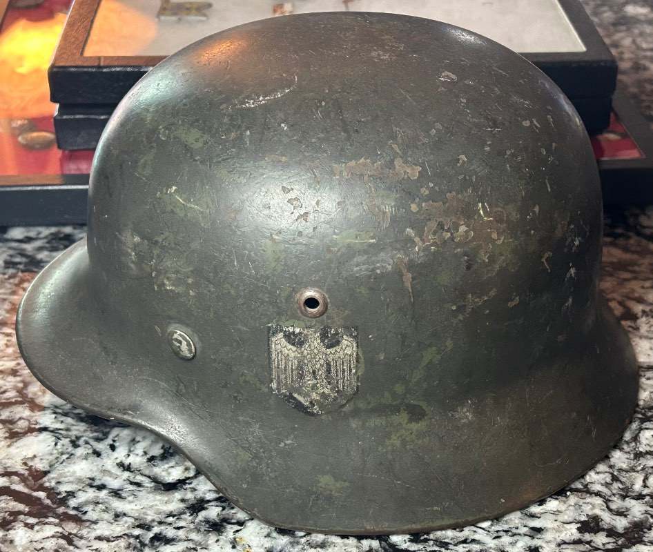

Fiziwater Posted September 27, 2025 #25 Posted September 27, 2025 As a frame of reference, I picked this up in 2014 from Hugh Brock, a knowledgeable dealer (RIP), for $595. German M18 Helmet and Liner (WWI helmet reissued in early WWII) His description: This helmet is the last variation of the original 1915 WWI helmet where the chinstrap was mounted to the lining instead of the helmet shell. This helmet was issued during the WW2 era with both the Army and national color decals. It was overhauled at a German Army depot sometime after 1940, brush repainted olive green over the decals and a new Army eagle decal applied. At the same time, the liner sizes that should fit this shell were ink stamped on the back rim. Here, they installed a liner one size smaller. Liner mounting band and chinstrap fittings are zinc plated wartime steel, chinstrap marked with an RB number and the name of a German written on the leather and another on the shell. String at the top of the liner is original. I have no idea what it would go for today.
