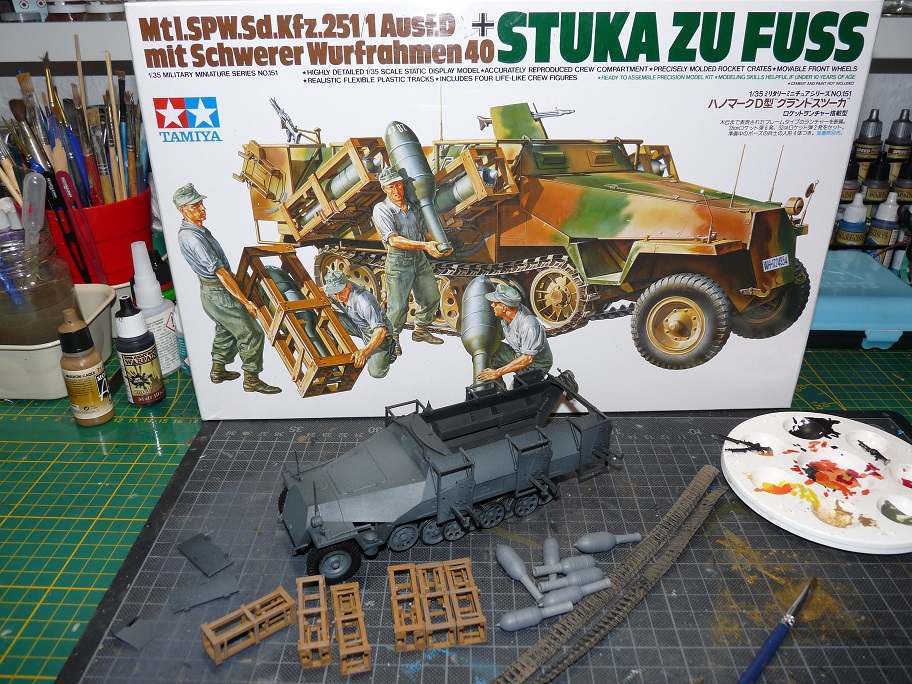

Proud Kraut Posted March 19, 2024 #1 Posted March 19, 2024 I´m about to complete my lates modeling project. It´s the Sd.Kfz 251/1 half track with launch frame 40 by Tamiya. The vehicle was called "Stuka zu Fuss" (Stuka on foot) by the German soldiers. So far an easy build. Currently I´m working on the weathering of the half track and painting of the figures. Not sure if the model will be part of a diorama when completed.

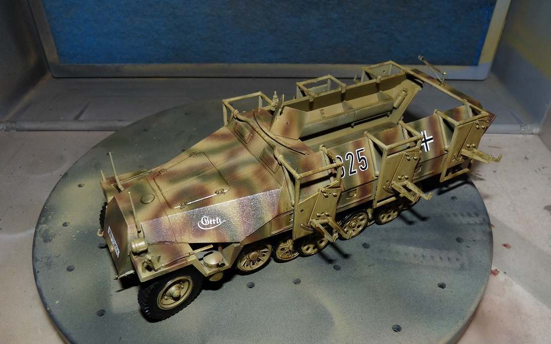

Proud Kraut Posted March 23, 2024 Author #5 Posted March 23, 2024 Actually I wanted to build a dark grey painted mid-war variant. Doing some more online research I learned that the halftrack "D" models were introduced in 1943, the year the Wehrmacht adopted the 3 colors camo pattern for their vehicles. So I had to paint the model again. This time I used Tamiya XF colors.
ArtyScout Posted March 24, 2024 #7 Posted March 24, 2024 Nice job on that three color camouflage. Semper Fi. Manny

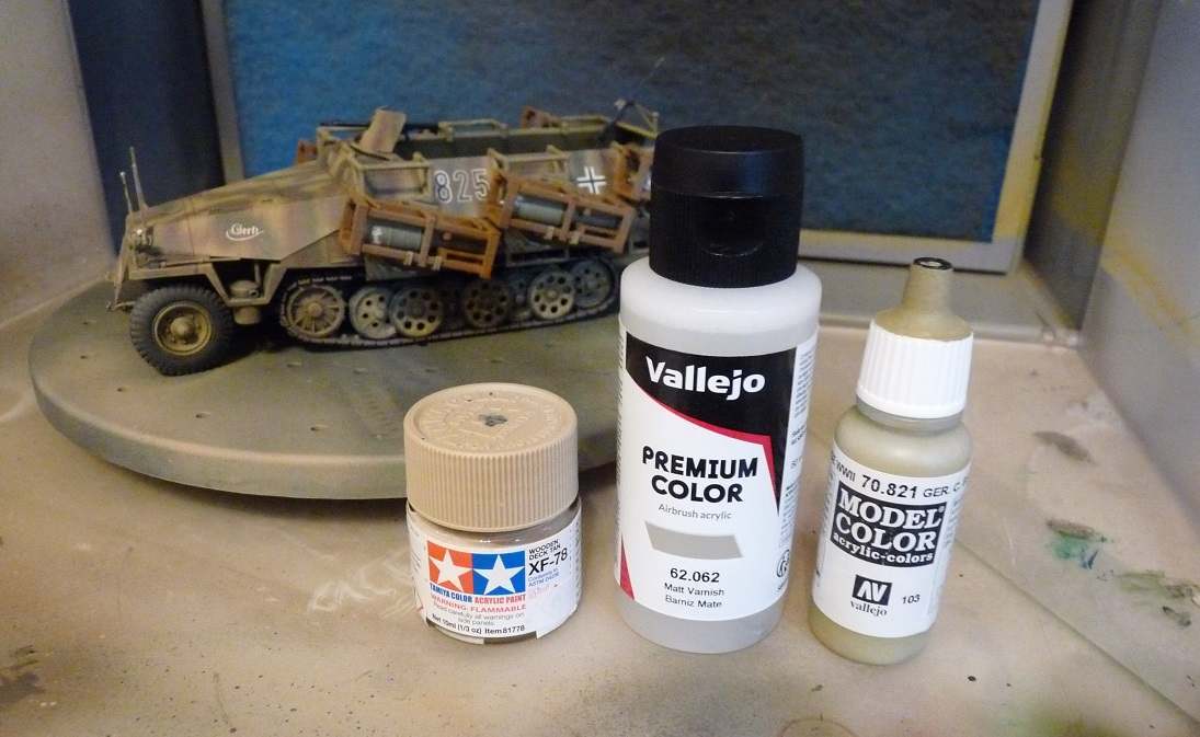

Proud Kraut Posted March 24, 2024 Author #9 Posted March 24, 2024 Before I applied decals and washes the halftrack received a coat of clear gloss varnish.

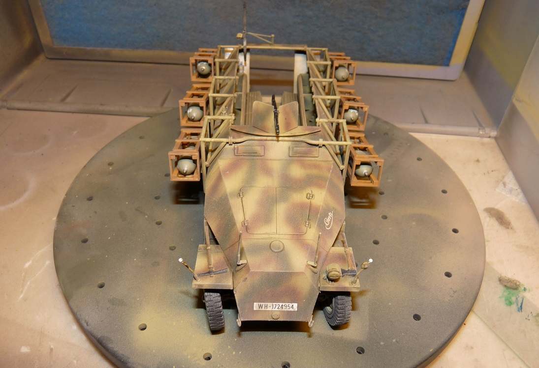

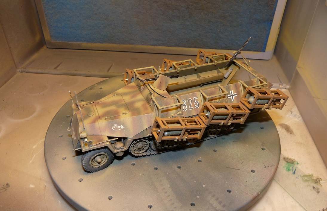

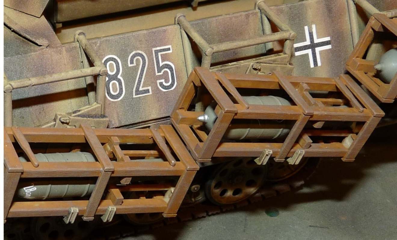

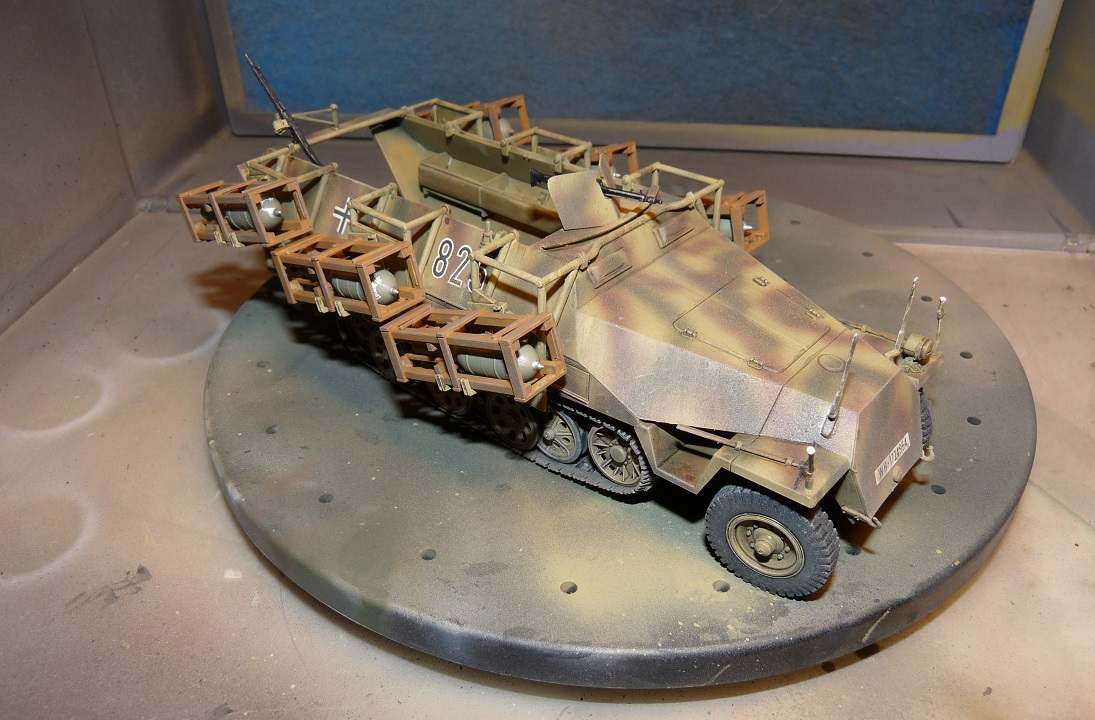

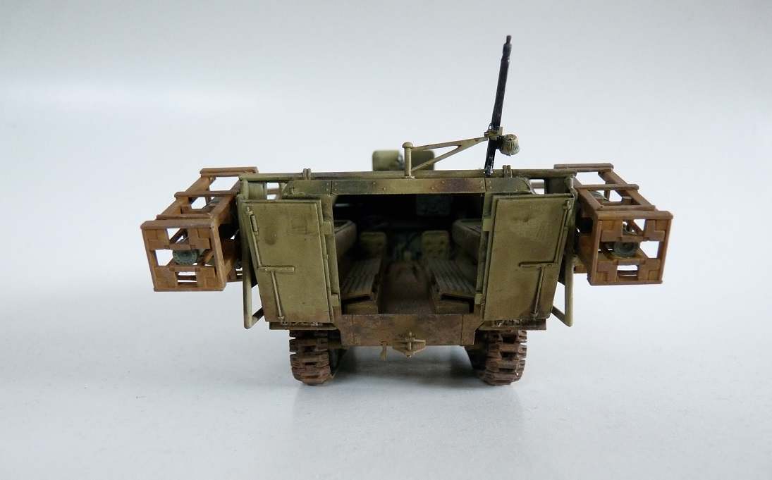

Proud Kraut Posted March 26, 2024 Author #10 Posted March 26, 2024 The gloss varnish has done it´s job. After I have airbrushed the halftrack with matt varnish again, the glossy borders of the decals aren´t visible any longer (see last picture of this post) From the distance I airbrushed the whole kit with some dark yellow color and drybrushed it with dark sand acrylic color. The halftrack is now united with it´s rockets and MGs etc. Unfortunately the tracks are too short. I have to fix the upper half on the wheels before I´ll start with the the next steps.
ArtyScout Posted March 30, 2024 #14 Posted March 30, 2024 WOW, nice job Lars. The whole vehicle is outstanding. I love how the rocket brackets came out. The weathering is exceptional as are the decals. Semper Fi. Manny

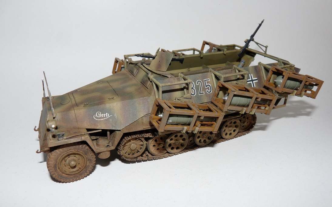

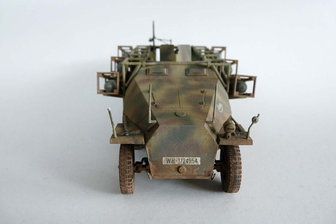

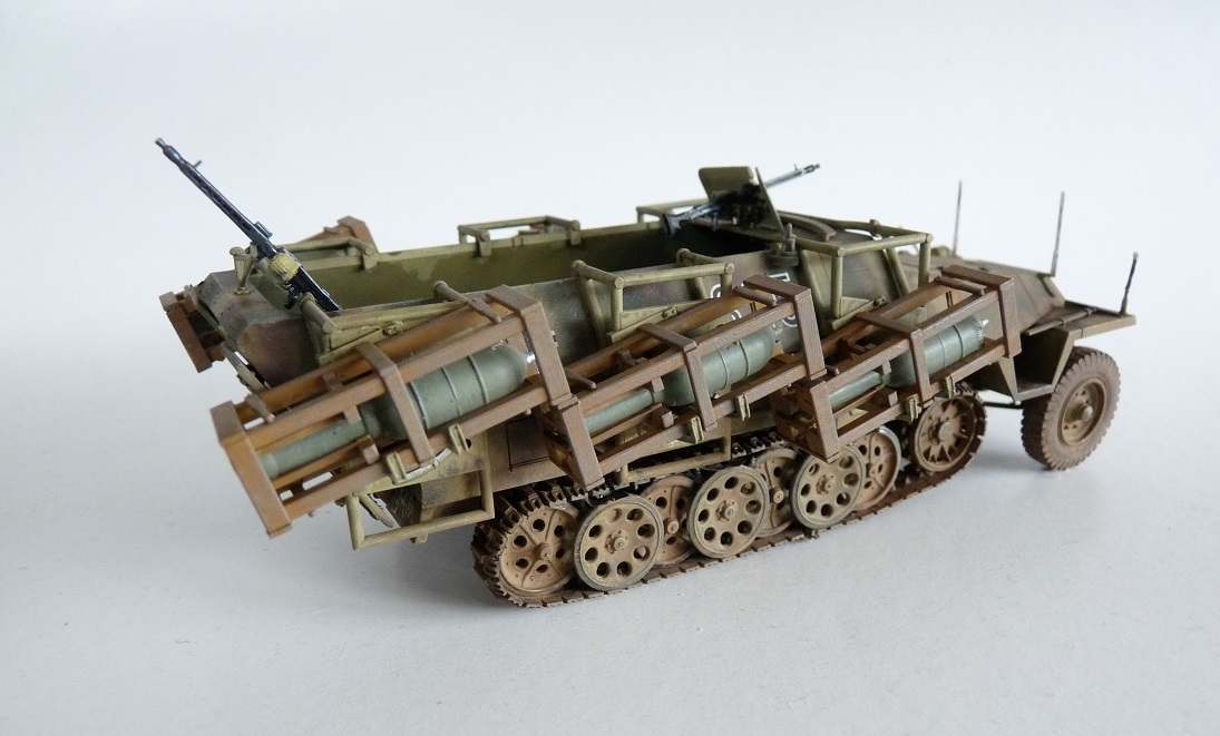

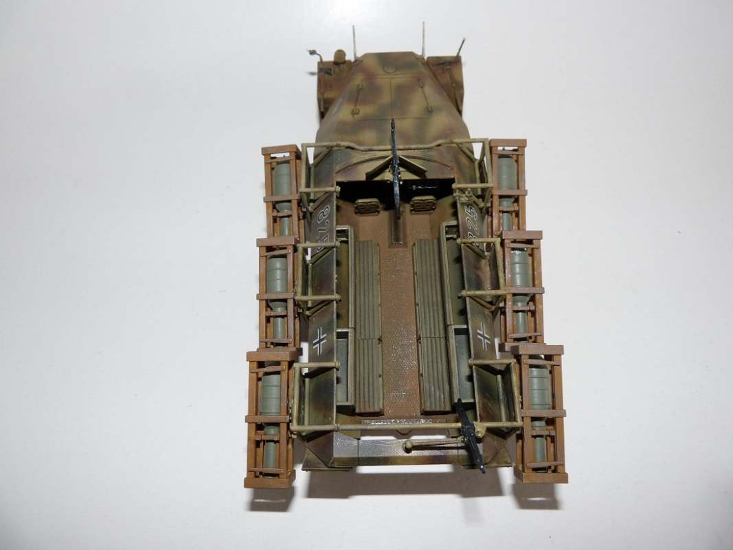

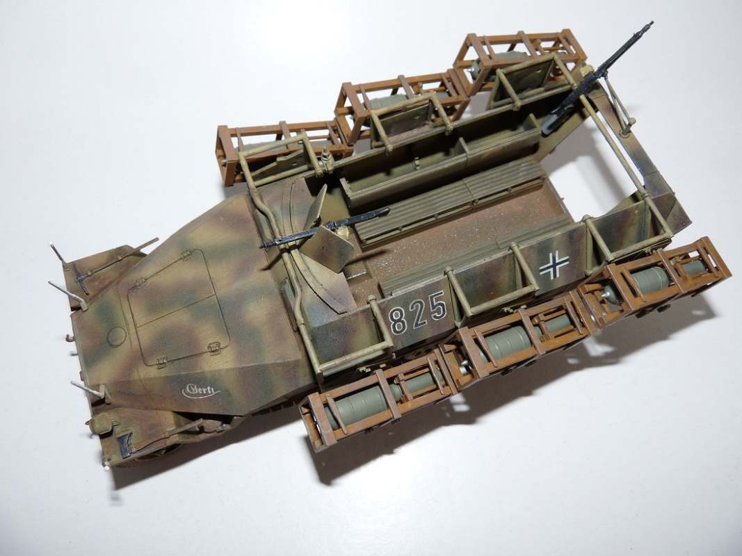

Proud Kraut Posted April 1, 2024 Author #17 Posted April 1, 2024 Thanks to all for the kind words, I appreciate it! You´re 100% right, tthen. The rockets were launched from the vehicle. Please note the two vertical bars at the front of the hood. They were used to adjust the whole vehicle towards the target. Since I don´t know if the SdKfz will be part of a dio, I didn´t add any figures and personal equipment. I finally applied MIG "Europe Dust" pigments, mainly on the chassis and the lower half of the SdKfz. Some more photos of the completed model. Thanks for looking!
