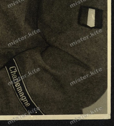

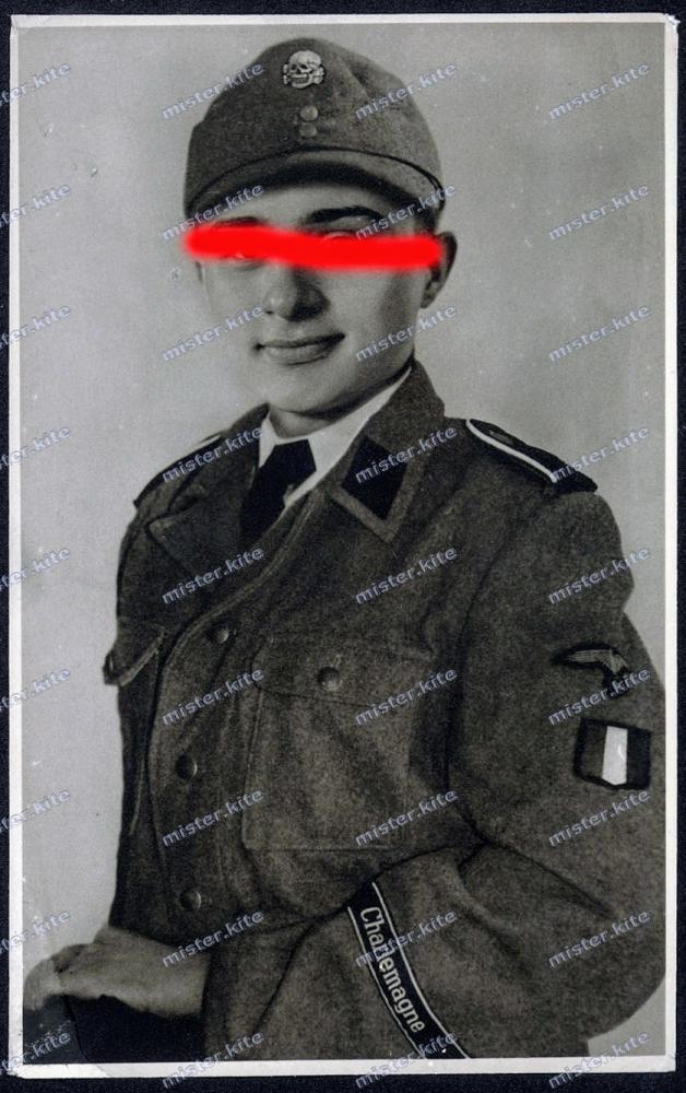

I have recently been sent scans of some SS portraits. The portraits show 'Extremely' rare insignia being worn. Leading experts in the field don't believe the portraits are original due to the units involved.
Anything is possible, but the possibility of these portraits bring original is extremely small.

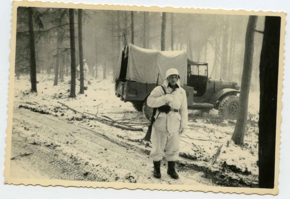

Here is a reenactor photo that was made to look like a period photo. One of my Early SoS buys. Kept it to remind me to always be aware.
Mike

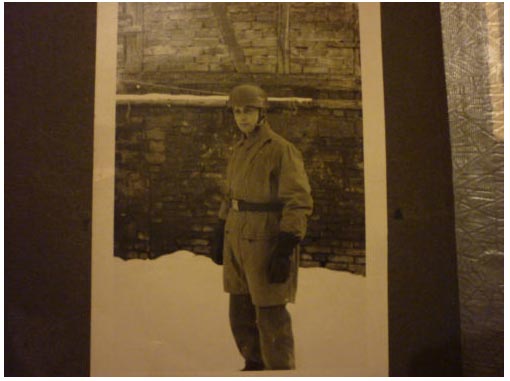

A couple more reenactor fakes...
Mike
Nice example. As you noted in your previous post, the fault in this photo is that every thing looks so squeaky clean. Few reenactors want to rip up or dirty up their uniforms and gear, original or reproduction. Even the truck in this looks too clean.
I feel bad when reenactors put photos of themselves on our Forums and ask "What do you think of my impression?" My first thought is that you have come straight from the unit supply sergeant and drawn completely new equipment. Sometimes the reenactors will go without shaving or otherwise dirty themselves up, but their uniforms and gear still looks like it was made yesterday.
Also look at the sharpness and detail on some of those posted above: it looks like those "Germans" carried top of the line Leicas for the personal snapshots.
