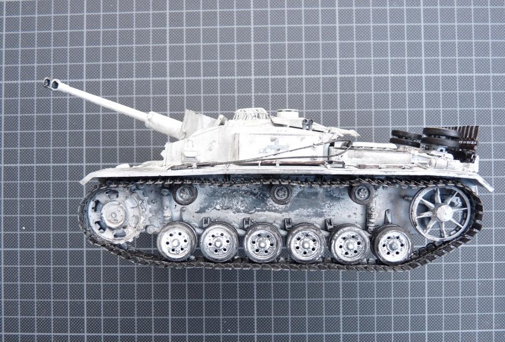

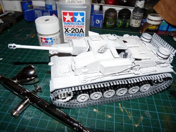

Today I airbrushed the StuG with Tamiya XF-2 flat white acrylic paint.

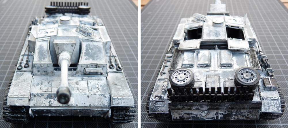

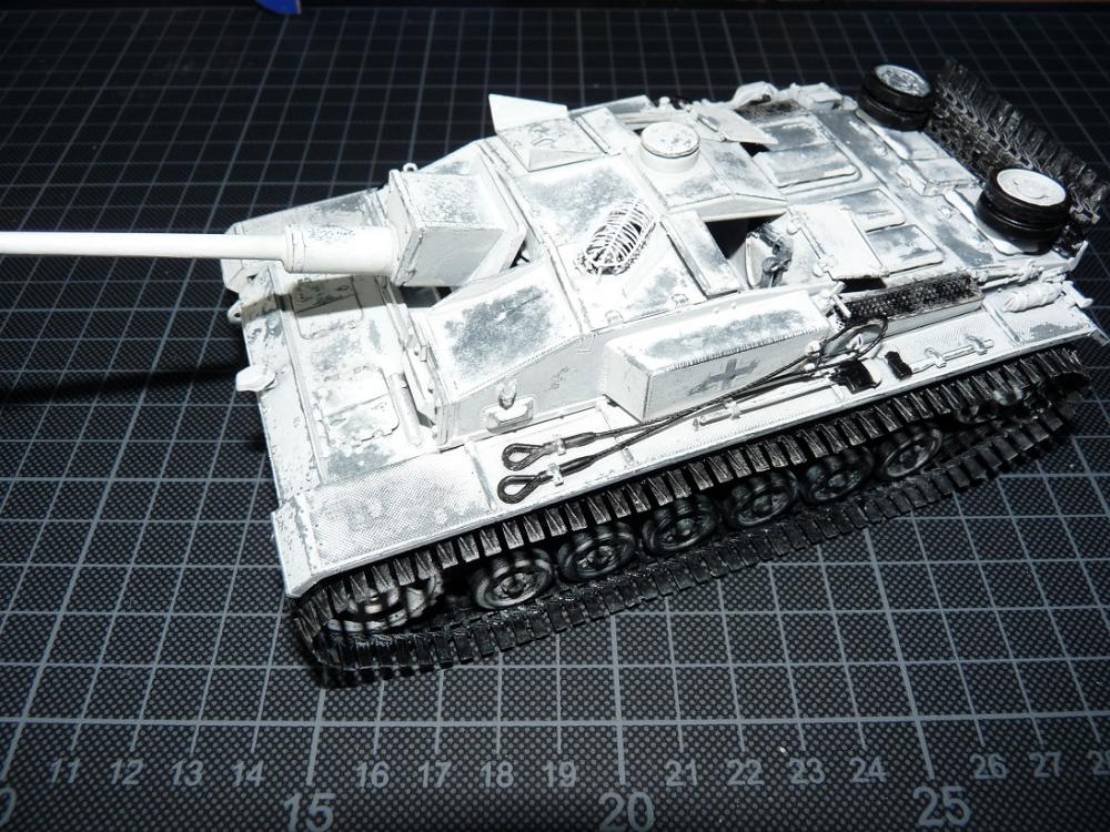

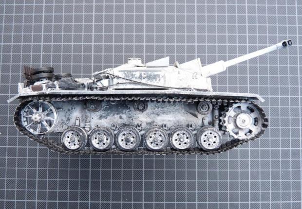

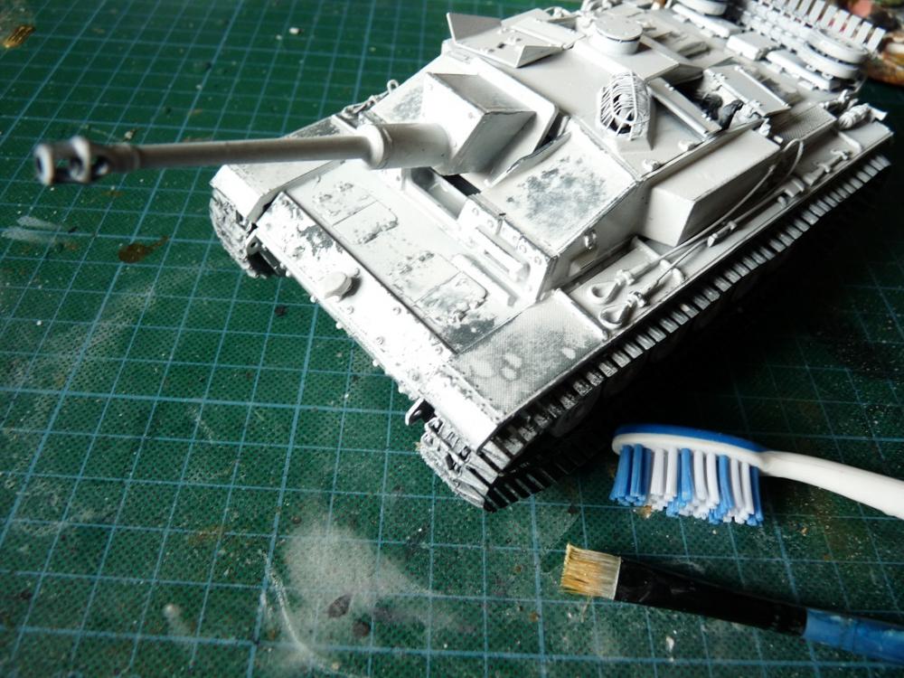

Hairspray chipping. The idea of this technique is to achieve a used and washed-out look of the vehicle's coat. This works very well with winter camo. After the white paint of the StuG has dryed completely it is partially brushed away with a wet brush or in this case toothbrush.

That's looking nice, Lars. Worn whitewash over gray base is a classic finish that you are carrying out fine.

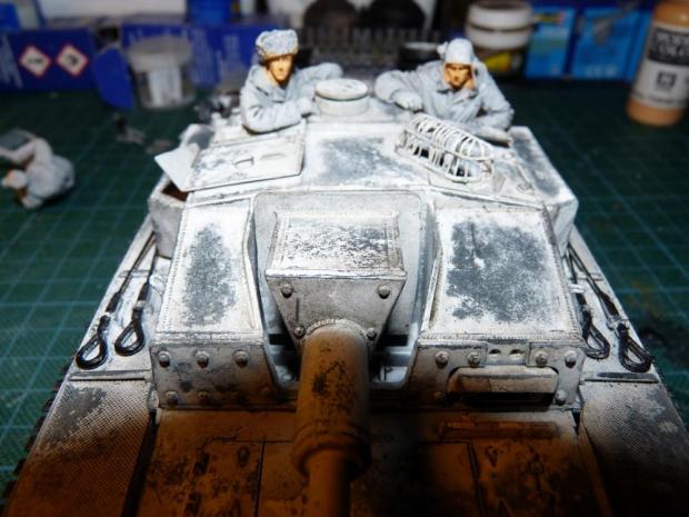

Summer holidays are in sight so not much progress these days. Meanwhile the crew has arrived. A set of two resin figures. After building these they received their first coat of primer.
#40
They fit perfectly to the winter StuG.
#41
it looks Great Lars. Great paint technique.

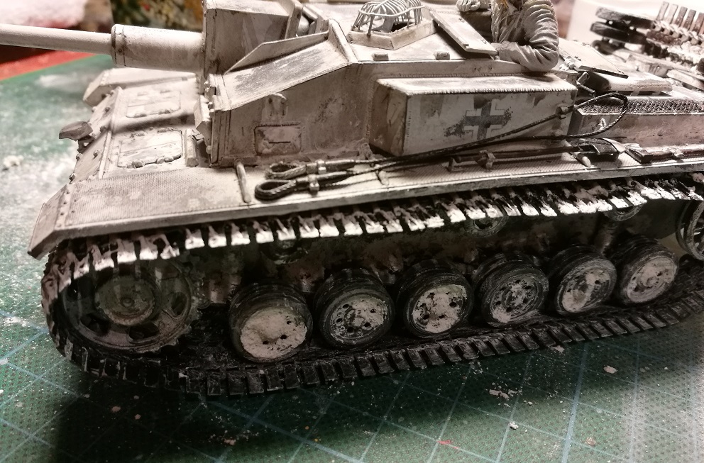

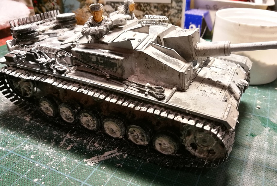

Although not much time for modeling these days I really want to complete the M40 and the StuG III projects in 2019. Today I added some remaining snow to the StuG's chassis. I'm not 100% lucky with the results, trials are ongoing....
#44
#45
#46
Hey Lars, nice work on the weathering and snow. BTW I do like how the snow looks. I'm looking forward to the riding infantry.

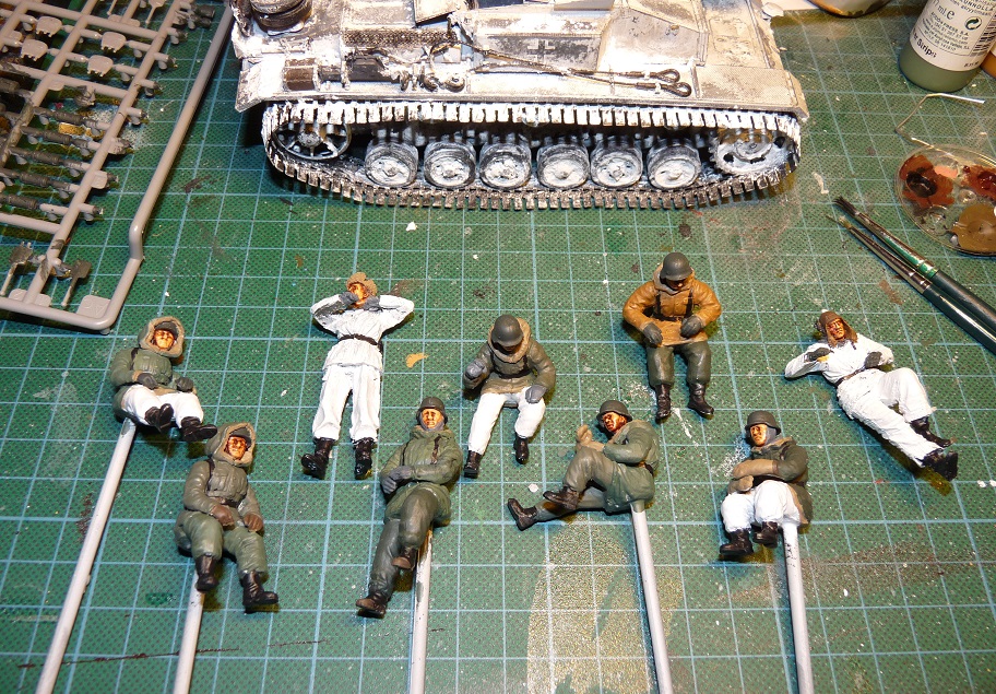

Maybe I´m able to finish at least this kit this year. Here´s the riding crew with applied base colors.
#48
That is a fantastic paint job.
#49
Lars, the figures look great! They are really going to add a lot of interest to your StuG.
