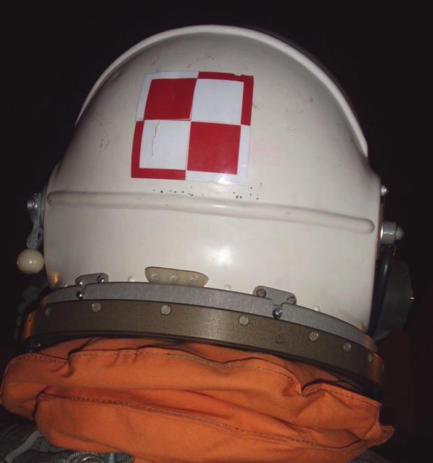

Helmet GSh-6M was maybe outdated by early '70s, but some photos show there was no particular haste in upgrading to the -A variant. After all, it was quite similar and the basic working was utterly the same.
Visible here, the complicated neck ring if compared to GSh-6A's - a system of bearing balls inside, and the upper portion revolved over it when the head moved sideways. Replaced by the much simpler type in the subsequent variant,

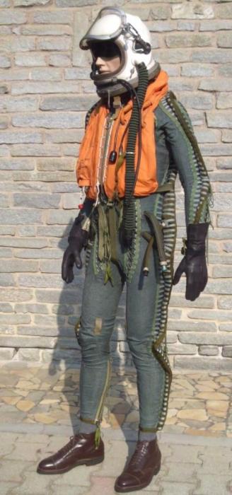

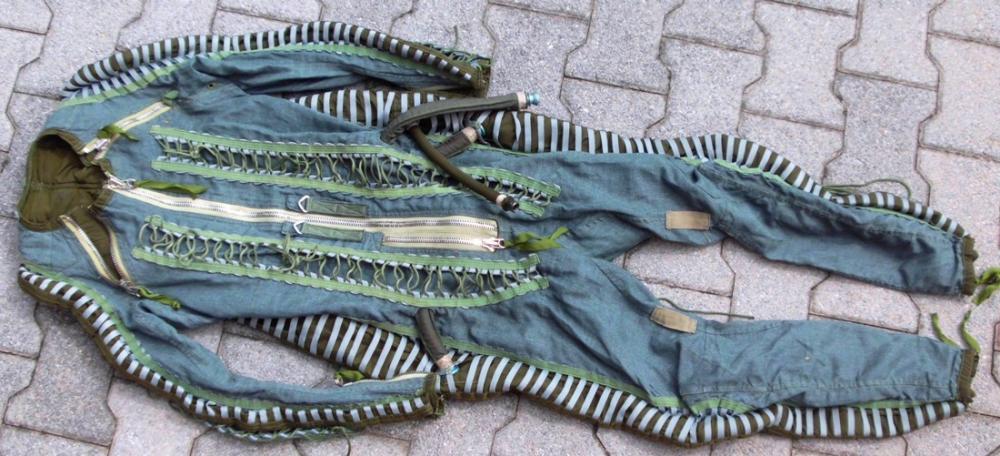

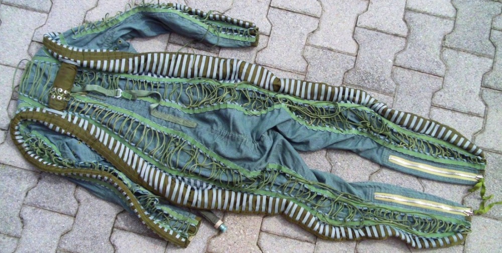

The Polish-made WUK-67 partial pressure suit, derived from the Soviet VKK-6(M). Came out in some color variations, this one is dated 1984.

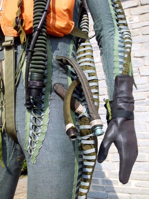

Shorter and smaller hose inflated the external 'capstan' tubes instantly in case of emergency ay very high altitude when depressurization occurred, the tubes inflating and expanding more than twice their diameter. The attached (interlocking) tapes they are sewn to, pull the already snug-fit suit in ordet to act against the body with mere mechanical counterbalancing, thus preventing tissues from swelling and lungs/ribcage from expanding due to oxygen forced inside (pressure breathing at 100%).
The other, softer hose if for 'Anti-G' purposes and does works separately with compressed air (not oxygen, like the former hose does).

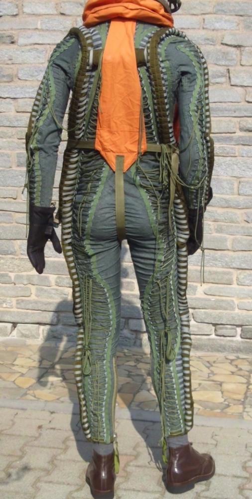

WUK 67, front and rear

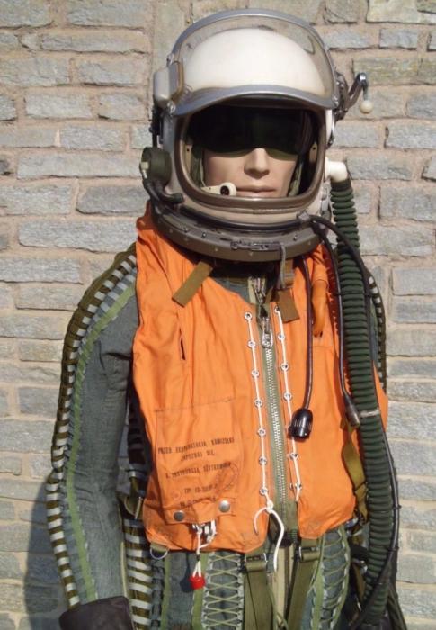

Polish-made KR-7 Life Vest ('Kamizelki') came out in basic variant + 2 (slightly) enhanced ones. This the third variation, Typ: KR-7 Seria 3
Here the second variation, worn by the mannequinn, Typ: KR-7 Seria 2

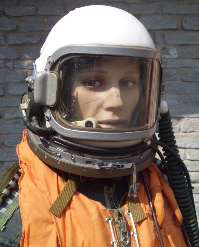

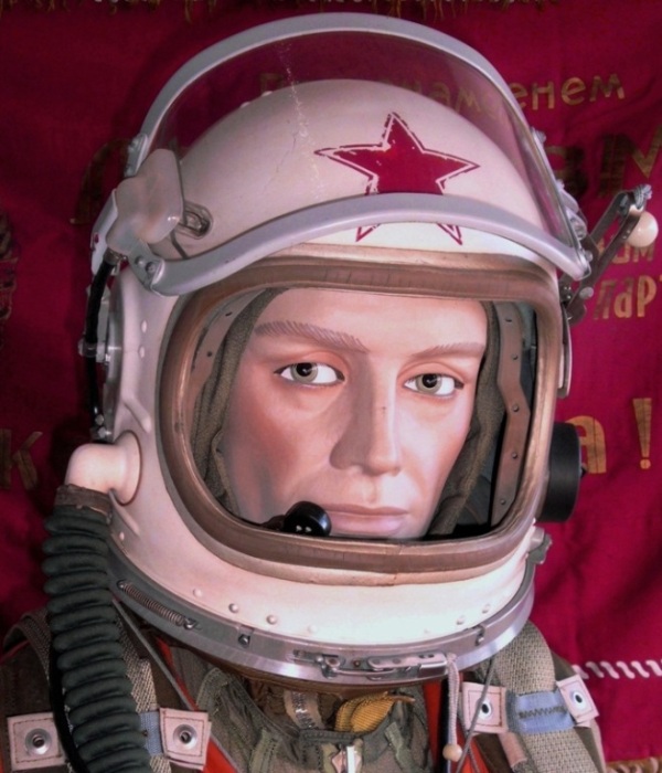

Pressure visor of GSh-6M down and locked, the inside soft helmet carries the side boom michrophone for communication. Differently from similar US-made helmets, in the URSS-designed models a seperate communication soft fabric helmet is worn first, then the outside shell comes.
Shell is metal-made (!!) and is, according to some sources, the same high-quality duraluminum (aeronautical) alloy used for making some parts of MiG and Sukhoi planes.
Helmet GSh-6 is still currently made in its latest (and last, supposedly?) -6LP variant at the 'Tieploobmiennik' firm of Nizhnyi Novgorod.

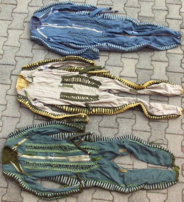

here again the WUK 67 suit (closest to camera) and two variant of its successore, the almost identical WUK 90.

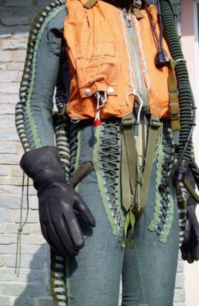

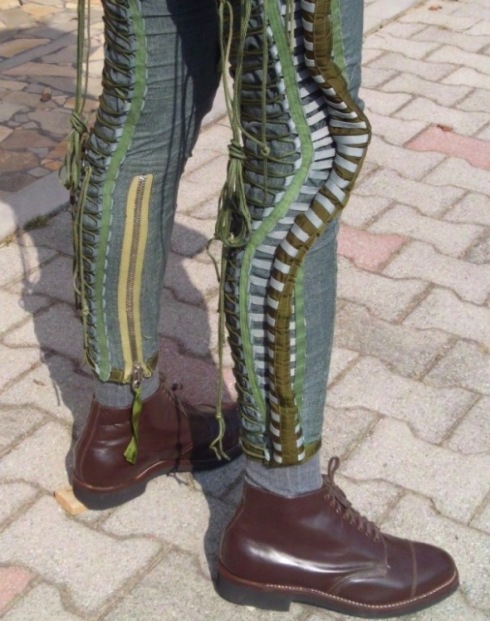

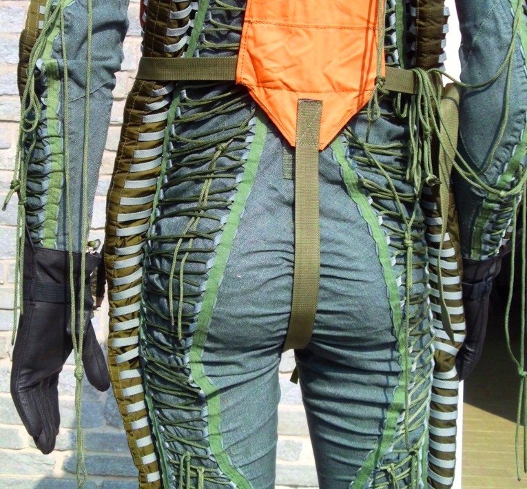

A complex network of interlacing strings do adjust further the suit very snug, after it had been selected the very right size (ten available sizes, from 3 to 12) to perfectly fit the pilot.
This way should the capstan tubes inflate at full force in emergency, suit is forced to push hard against the body and counterbalance (just mechanically) body's inside pressure trying to exit towards the very low-pressure outside environment - a depressurized cockpit, or while the aviator is falling following the ejection.

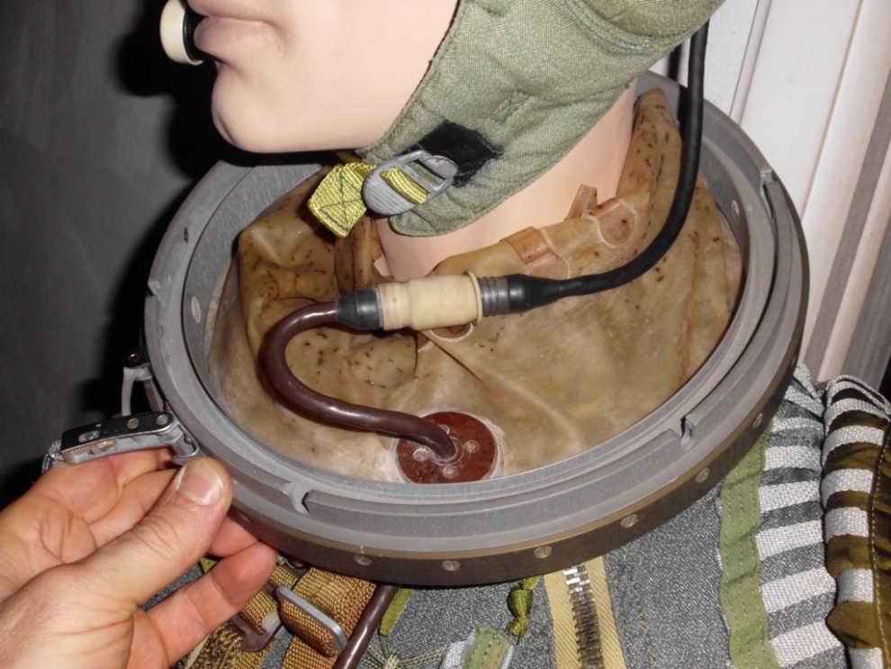

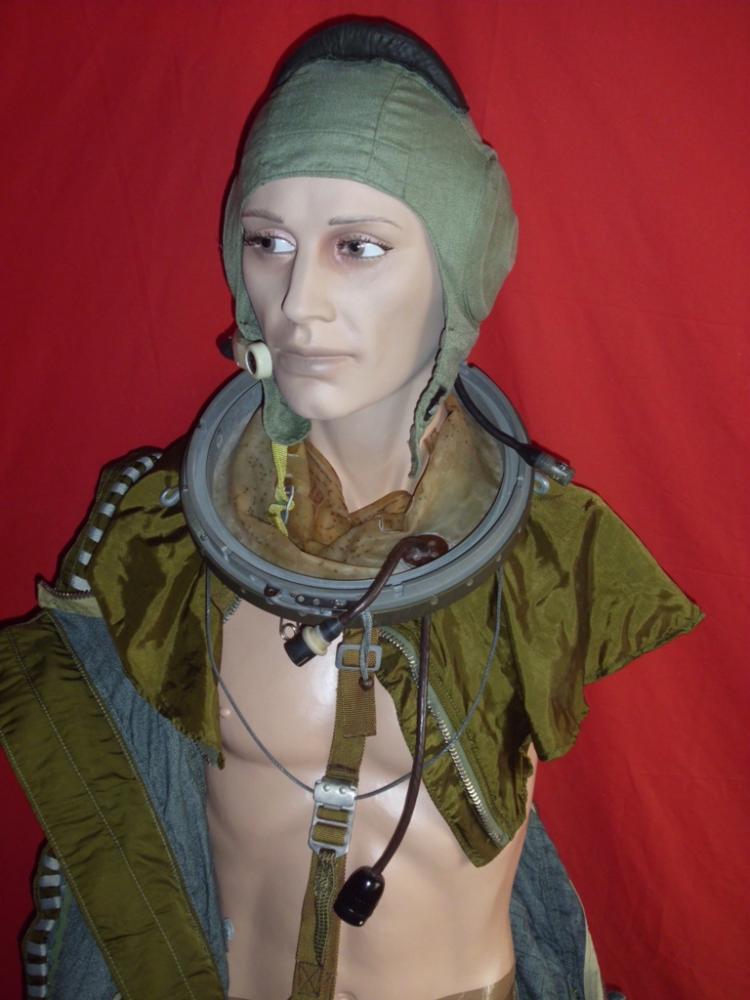

here inside the receiving ring of GSh-6M. Communications cord exiting soft helmet's rear, does attach to this short segmet - sort of an extension cord ending ouside in a massive, bell-shaped plug. This in turn does pass through both the sealing collar (made of surgical rubber, to keep seperate the head in a oxygen-filled environment) and fabric of this shoulders 'skirt' (integral to neck ring) and does exit below man's throat, left-side.

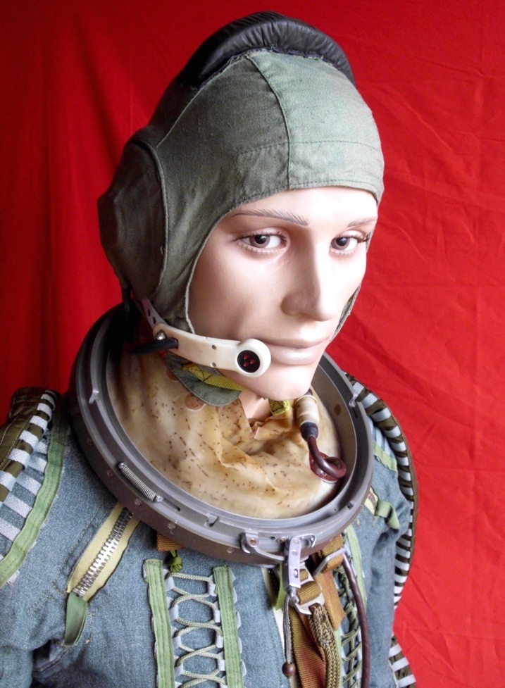

internal soft helmet for communications. Sub-variations of boom mike can vary in shape and colors (all are URSS/Russian -made, as well as the hard helmet) but basically doesn't change too much.
The upper-placed leather pad (plus another one at the rear, making a "T"-shaped total pad) will fit into proper notches of shell's inner padding and helps in moving the whole together with the head.
