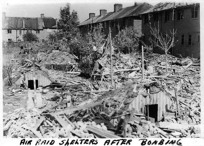

Here are 3 photos of England  I got in a collection of 50 from a US soldier stationed at an American Air Base in England in WW2. The "tank busters" in one photo are interesting. How did they work?

Any indication of where the air raid shelter picture was taken?
