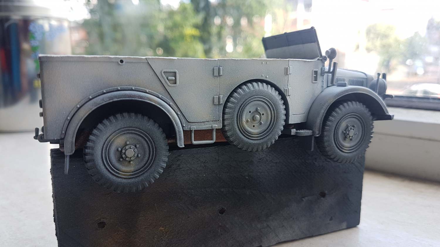

I am very busy at work during the week so I can only do some modelling in the weekends for now. The Horch is now in its base colour of Vallejo 71.054 Dark Grey Blue, and even though it will get a worn winter camouflage with the hairspray-technique I will highlight and weather it a bit first, as it is good practise anyway and some of it will show up when the winter camo is weathered.
No mud though, as I doubt there was much liquid mud in -30...
For the seats I used a mixture of Dark Blue Grey, Elfenbein and Dunkel Grün in about equal parts, that was thickly applied with a brush to simulate a canvas texture with slight creasing:
As I got some dry-tip near the end of the spraying session I got some drops on the floor, but those will be hidden from view. Lesson learned is to add some retarder if I have to spray bigger areas.

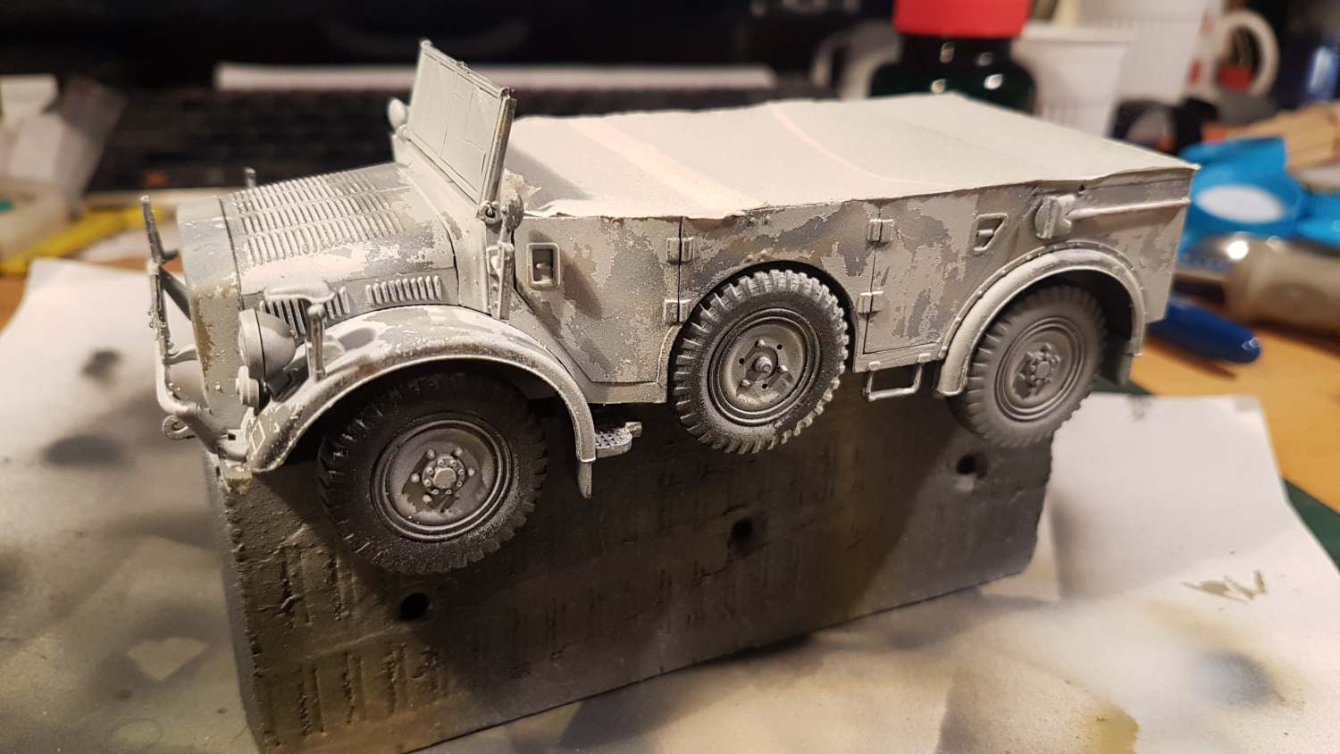

Time for the wintercoat.  First I applied 2 thin layers of hairspray (the cheapest I could find) and let those dry; it made the model quite glossy:

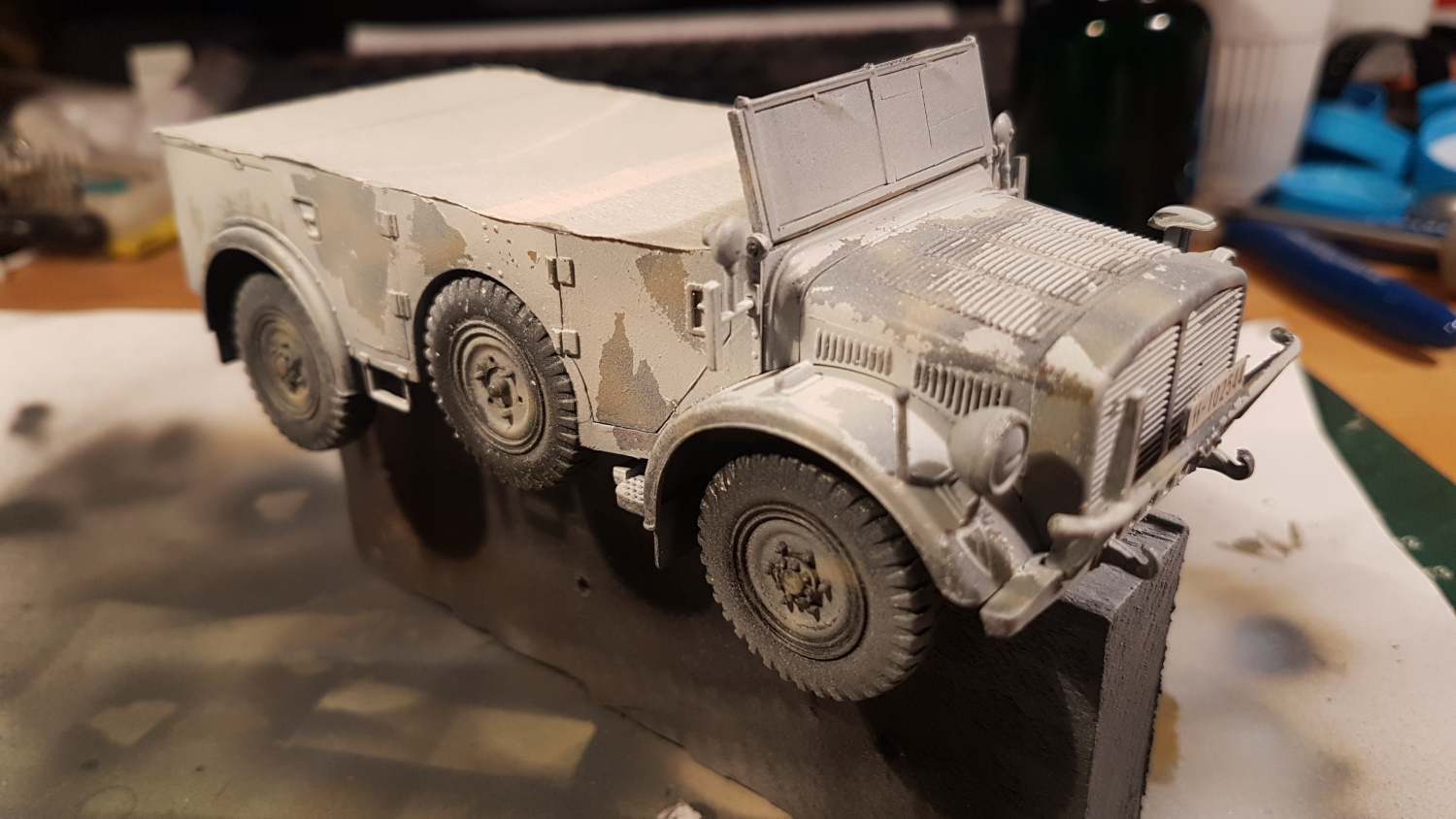

I then sprayed a thin coat of white mixed with a drop of Elfenbein over the whole vehicle. This coat was thin enough that you could still see the camouflage paint underneath:
After that dried I started scrubbing with a wet toothbrush. I found out that if the brush is too wet with this cheap hairspray, it will immediately take off whole sections of white but if it's just a bit moist it works pretty well. For smaller nooks & crannies I used a moist stiff brush and with a toothpick I created some smaller random scratches.
The next step was to apply 2 more thin coats of hairspray and let those dry, followed by another very thin, misted coat of pure white this time. This again was then treated again with the moist toothbrush, concentrating on sections that weren't scratched before. This creates some depth to the paintwork and you can repeat this process as often as you want, but I think 2 is enough here.

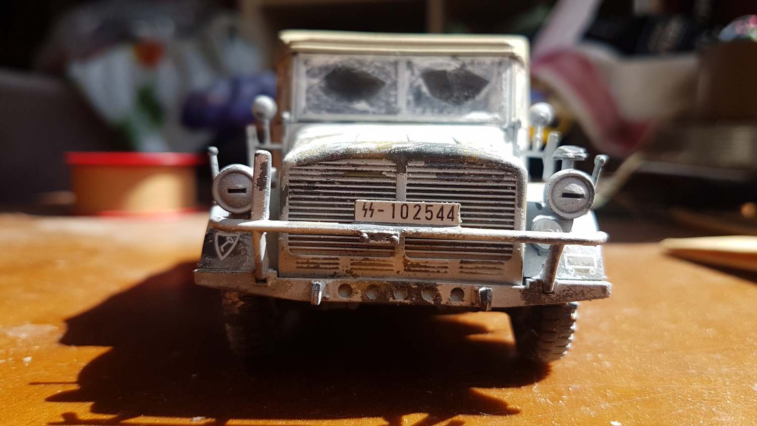

I cut what would be the area the windshield wipers would reach from tpe and put that on the windshield. I scraped some white pastel chalk and mixed that with a few drops of water, and applied the chalky paste with a brush in a dapple motion of all the windows. After letting it dry I removed the tape from the windshield and used a dry, stiff brush to remove most of the paste from the other windows, leaving plenty of it near the edges to create the impression of a snowy, frozen window that is quickly cleaned by hand.
I'm thinking about a applying a light brown wash to finish it. haven't decided if i should use the figure either, as he wears a smock which would be incorrect for winter.

First of all thanks very much for posting your step-by-step chipping technique here. I think you are off to a good start with the winter camo. Countless variants of white winter camo colors did exist, washable paint (mostly painted on, not sprayed on), chalk, crayon etc. etc. Most of these colors had in common that they were partially washed off during the winter season. The color faded because of use, rain, etc.
In this case you rubbed off big spots of white color. That works for the hood very welI. For the sides I would recommend to chip the white color the same way and size you did with the rust spots. Maybe you can wash off a little more in a second step. Anyway I would focus on those parts of the Horch that were exposed to dirt and use like door edges etc. I have marked some of these spots on the picture. So maybe a small wooden pin will work better that the big toothbrush. No criticism, just some remarks!
#17
Thanks for your comment! Most of those places were rubbed with the second round, but the bigger patches were the result of experimenting with how wet the brush should be to control the weathering. They were also partly covered again with the second spray.
