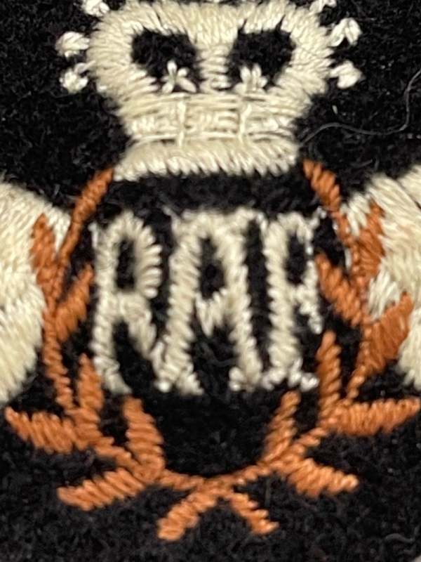

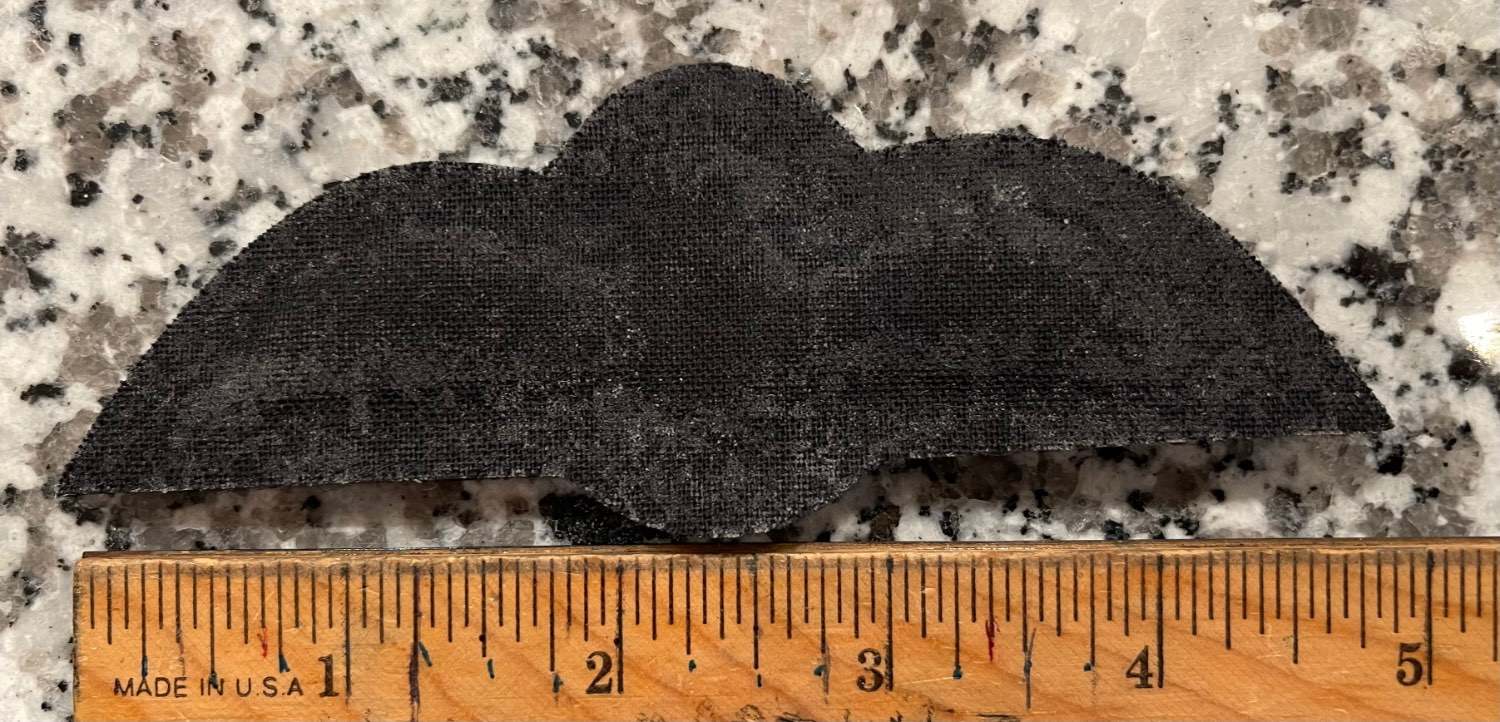

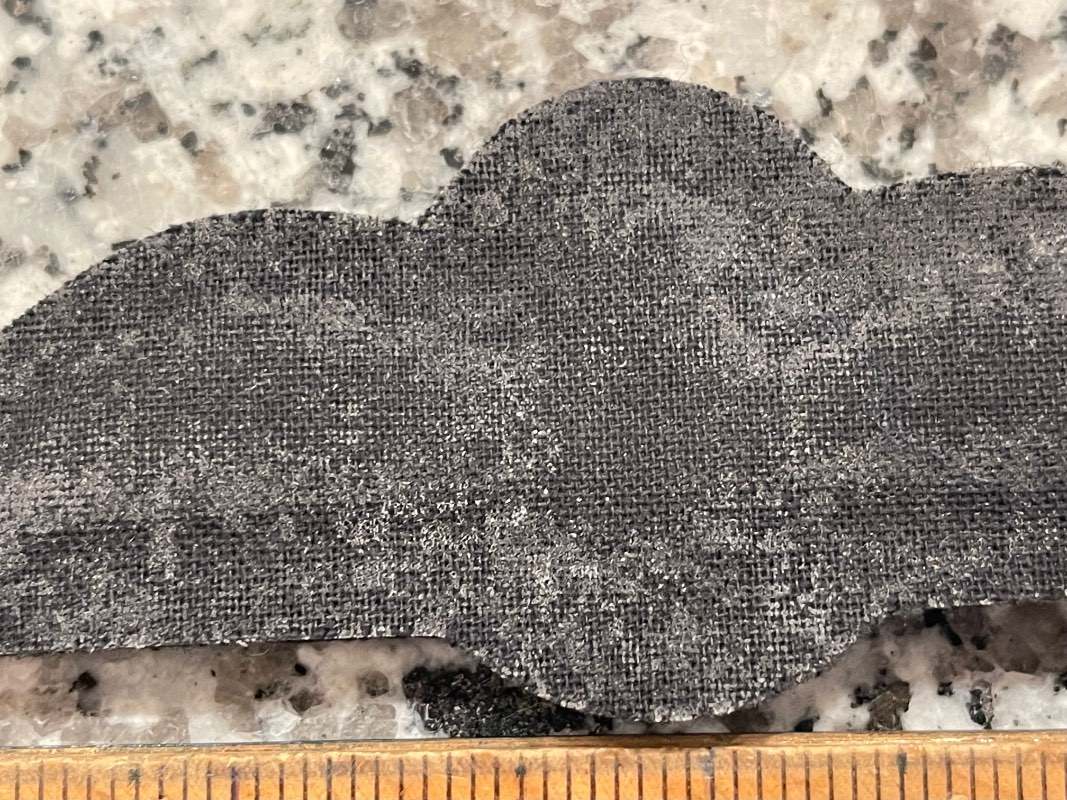

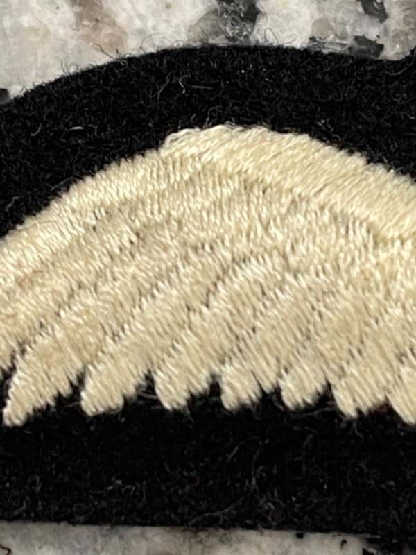

Good afternoon, I have been collecting ww2 US Militaria for some time. I’m now learning about British Militaria and Im excited to learn on this forum. I found this wing and wanted to know if it’s a original or reproduction. I tried to compare to others on the forum, but I’m not sure what to look for. Thanks in advance for the advice.

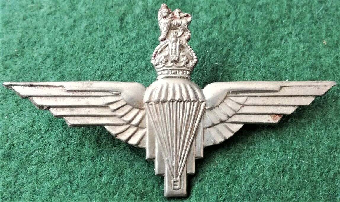

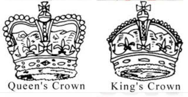

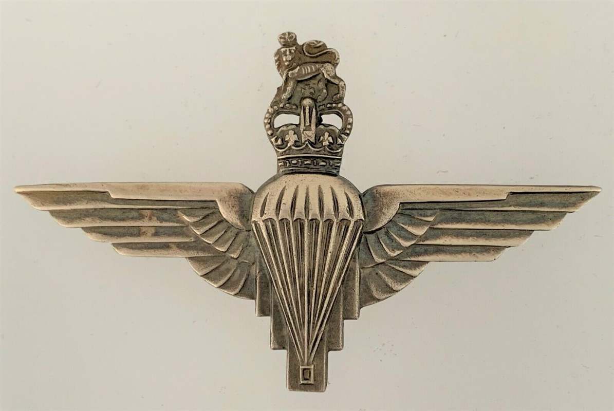

I'm not an expert on British insignia but one of the first things I learned was to look at the shape of the crown atop the insignia to determine if it is a WW2 era piece or a post war piece.  There was a change in the 1950s where by the King's Crown was replaced by the Queen's Crown.   Queen Elizabeth was inaugurated in 1952 but I believe it took until 1957 before the changeover was complete.  I could be wrong with these dates.  You can see the differences in the drawings of the crowns below.   You can see the differences with these crowns on the pair of British Parachute Regiment beret badges.  The RAF pilot's wing above has the Queen's Crown so it is post war and looks like a current made piece but I don't know for sure as I don't collect British aviation wings.

Adrian,
To add to Tonomachi's post, the wing (the British call it a brevet) that you have posted is indeed a post WWII wing. It could have been worn anytime between Queen Elizabeth's coronation and today. The crowns changed from the Tudor Crown to the Windsor crown upon her coronation. Her majesty's military forces had a window to change over from the old insignia to the new which I believe was about four years.
One thing that I want you to understand here is that the wing as it is produced here, is a post WWII manufacturing process. You will find all manner of wings produced this way to include brevets with "RFC" in the center and wings with Tudor Crowns. These were either made for collectors or for veterans and were not worn on the uniform. Tonomachi also brings up a great point regarding most British collectors- you had better do your homework before you make any purchases. The more advanced collectors seem to find it quite humorous when a novice collect purchases a fake, believing that it is part of the cost of the collector's education to have been burned by a reproduction being sold as a vintage original.

Thank you guys for the clear responses and the book recommendations. What caused me to struggle was these wings seemed to be quality made. I compared them to eBay reproductions and those were typically poorly made. So it makes sense that it is a post war crown, and manufactured for collectors and Veterans. This also explains why they are in nice condition.

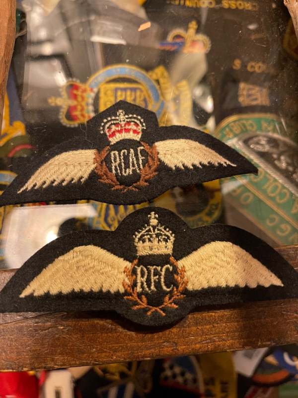

The shop where I purchased this also had a RCAF wing and a RFC wing made in a similar fashion. they were only about $15 each. Im happy to start learning about something new and look forward to being an active member of this forum. Thank you guys again for steering me in the right direction, As its much appreciated. I will post a picture of the other two wings I saw just for reference.

Little late to the party here but I will echo what Tonomachi and Allan H have previously said.  I am commenting on the last two wing (brevet) photos that you posted.  The first RCAF brevet is again post war with a Queen's (St. Edward's) Crown.  It looks modern made but again its use is from 1952 to present.  The 2nd RFC brevet is a modern reproduction made for , as Allan H points out, for veterans or collectors.  Again, as mentioned above, reference books are a must.  Another one to consider adding to your reference library is Warren Carroll's  "Eagles Recalled".
