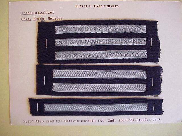

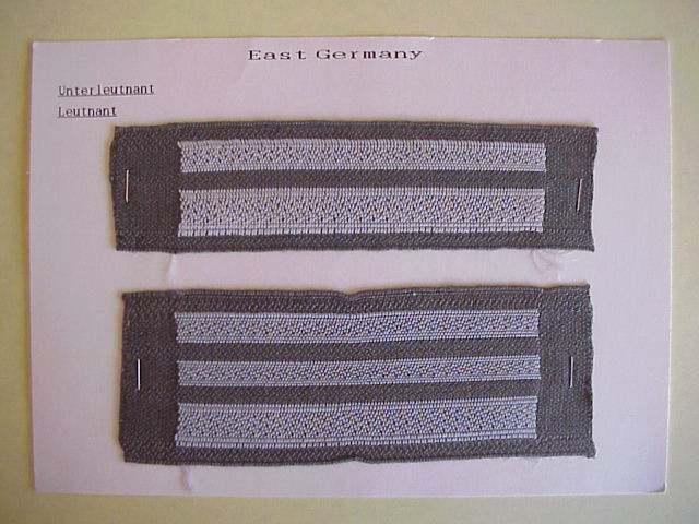

The uniform construction and tag certainly seems DDR to me.  Could this patch be the subdued rank stripes?  This could explain the lack of shoulder boards.  Look at these subdued insignia for some police examples.  These horizontal rank stripes were never fully accepted so perhaps your jacket is a prototype?

The weave of the material certainly looks the same.
