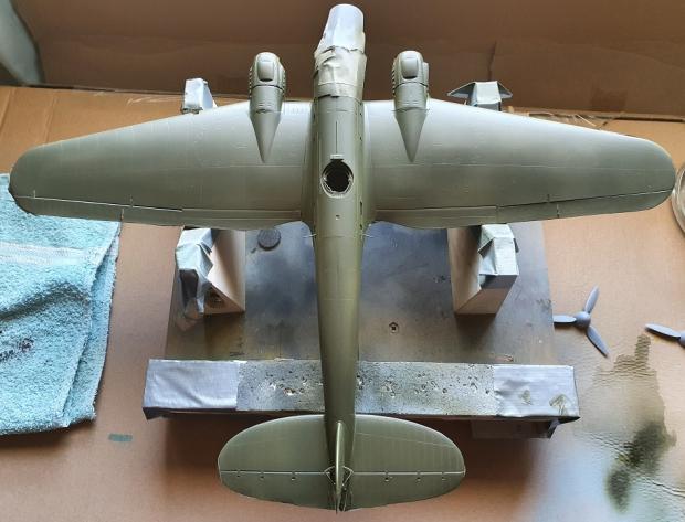

while the Heinkel has received it´s first layer of dark green color (RLM 71)...

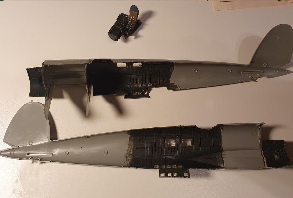

...the assembly of the H-22 variant has begun. As you can see I´m spending not much time on interior details or painting. It won´t be visible through the blurry clear parts anyway.

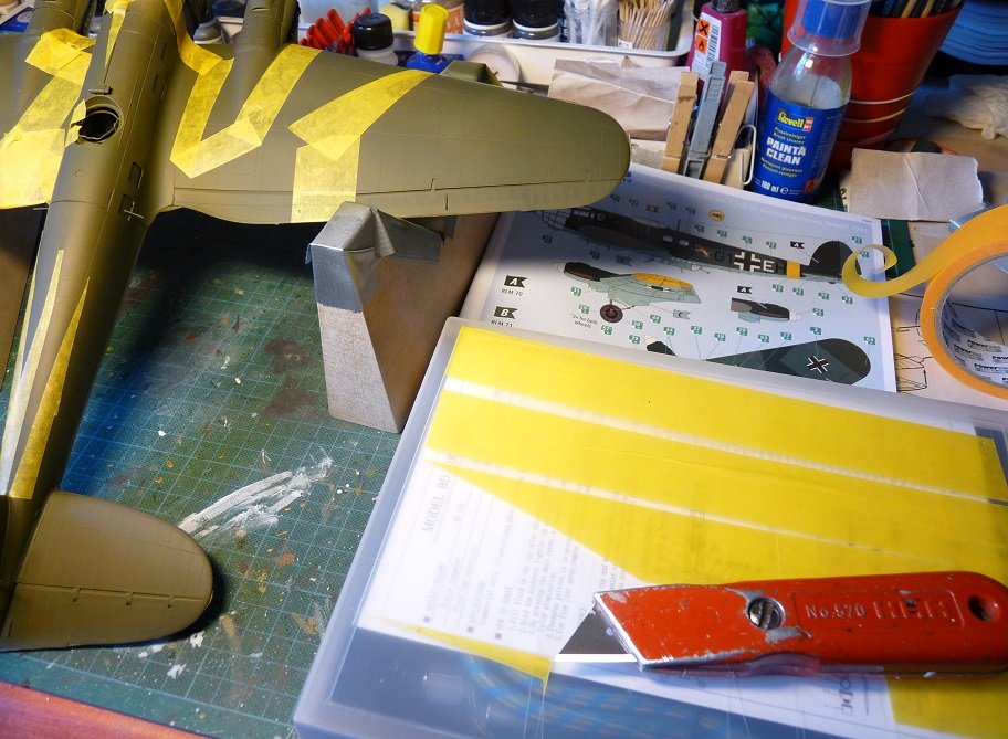

Masking the dark green color areas. I stuck stripes of masking tape on a plain surface (in this case the box of my spary gun). This is usefull to decrease the adhesive power of the masking tape (see below). It also makes it easier to cut the masking tape into pieces.

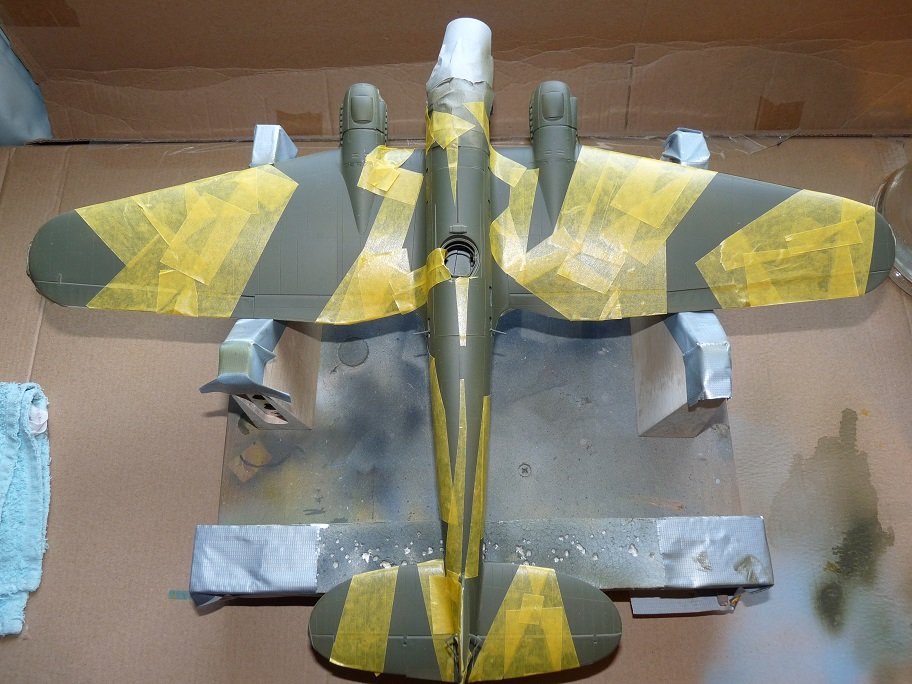

Here´s the Heinkel masked.

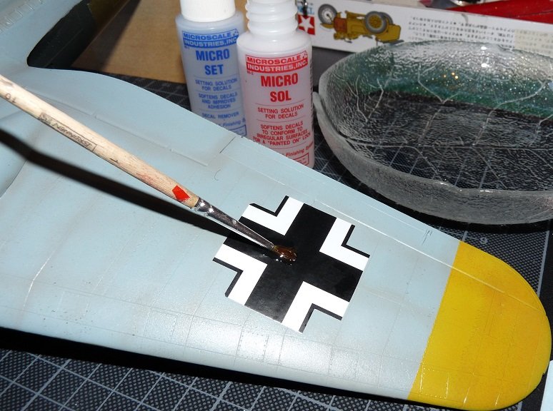

I have mentioned MICROSCALE Micro Set and Micro Sol before but will repeat it here in this topic as well. These products are very usefull to soften the decals and let them look like painted on.
So cut out the decals separately and dip them into water. Meanwhile brush Micro Set onto the proposed place of the decal.
#89
Attach the decal to the model and brush it with Micro Set again. let the decal dry and brush on Micro Sol if necessary. It will intensify the softening effect. You can see on the second pic that the panel lines are visible under the decal (and unfortunately dust as well).

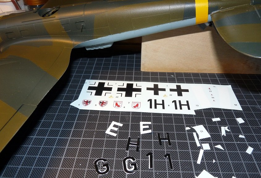

Side markings. To avoid the shiny silver borders of the decals I cut them all out separately. A lot of work but well worth the effort.

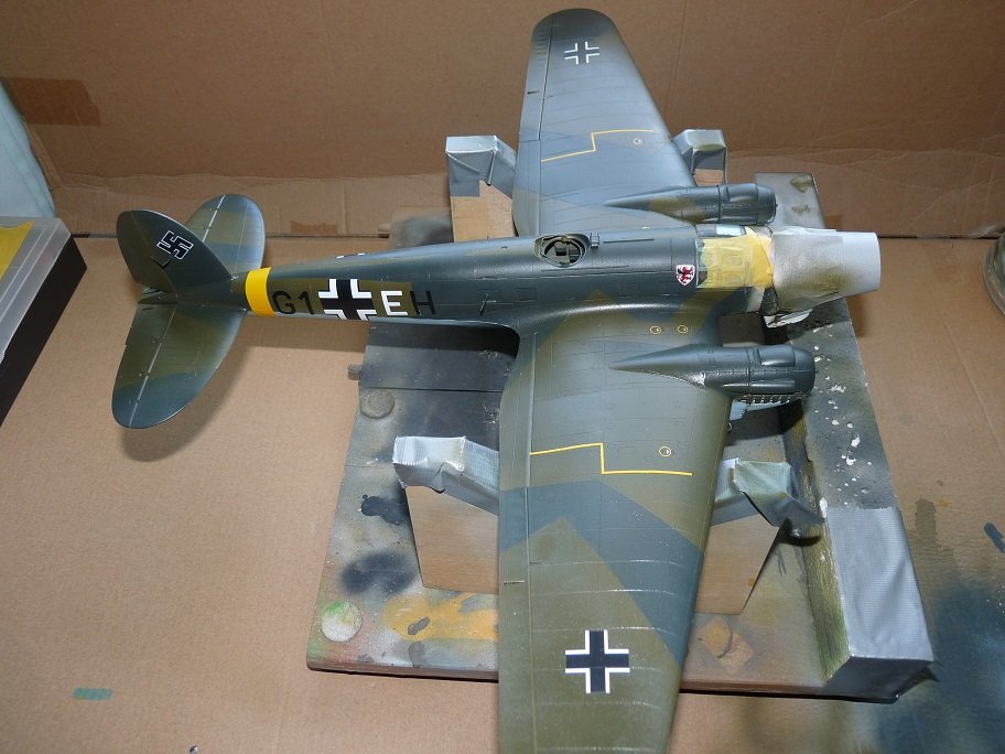

The Heinkel now with decals.

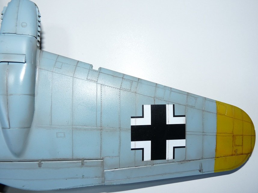

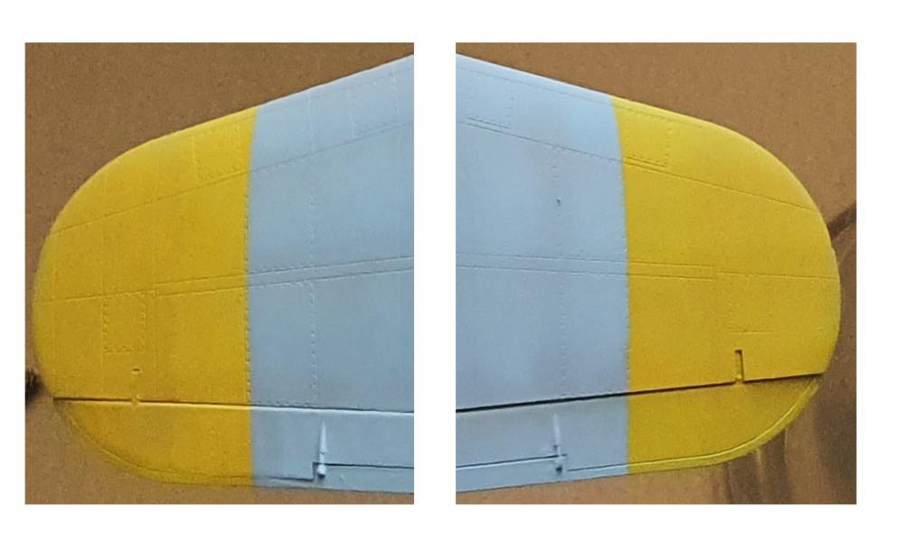

Details & weathering. Darkening the panel lines is one of the most time-consuming actions but well worth the time. You can use washes or paint the lines with a brush like I did in this case. For the bottom of the Heinkel I used TENSOCROM active surface agents. It´s a kind of water based color very similar to washes.
#96
Left and right wingtip before and after shading the panel lines.
