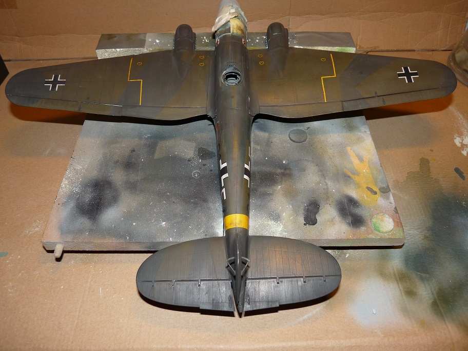

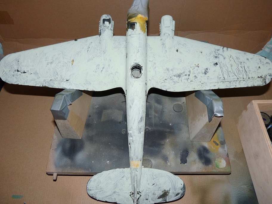

Looks horrible, doesn´t it?
#102
After the pigments have dried.
#103
And wiped away with a soft dry cloth. Is it too much? Would like to hear your opinion.
#104
It could be the pics but it looks rather dusty, instead of worn with use? Maybe with highlights and then washes or drybrushing?
#105
You are 100% right, I´ll fix that.

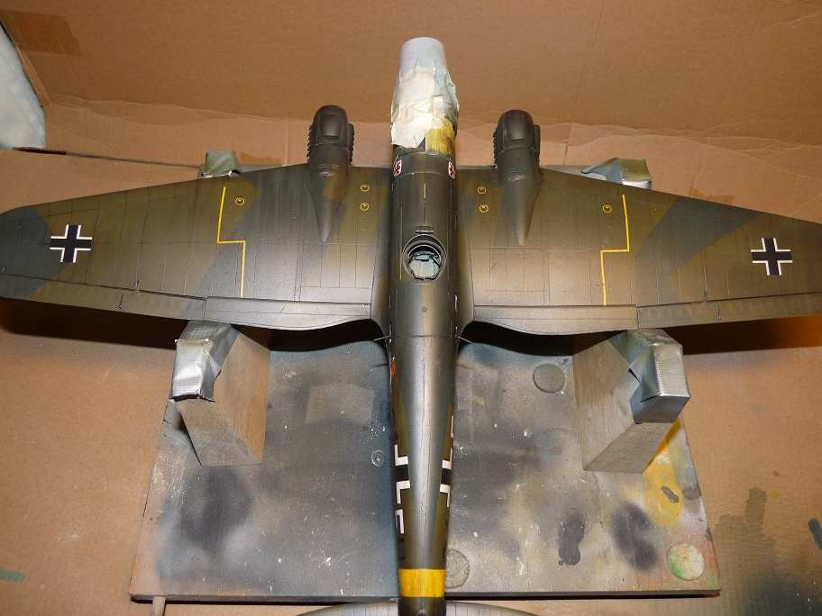

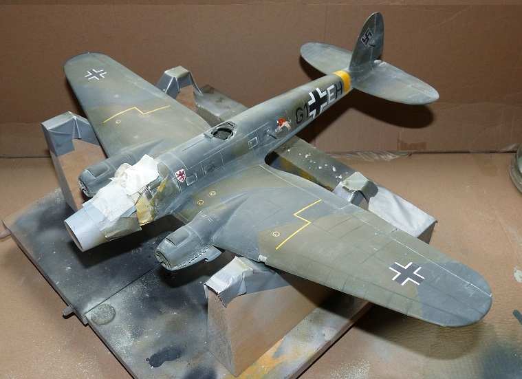

Thanks for your input mates! Still not really happy with the result but better than the light one. Here´s the black color wash.
#109
Now after the wash it looks like a plane that's flown a couple of missions over Britain. Nicely done.
Semper Fi.
Manny
#110
There has been much back and fort with the weathering so far. I have learned that a black wash is much too dark for the dark green colors. Fortunately I was able to remove some of the wash with spiritus. I painted the pannel lines with a small brush and I think I´ll leave it this way and go on with the detailing, chipping, etc. To save the last steps I sprayed on some layers of matt varnish.

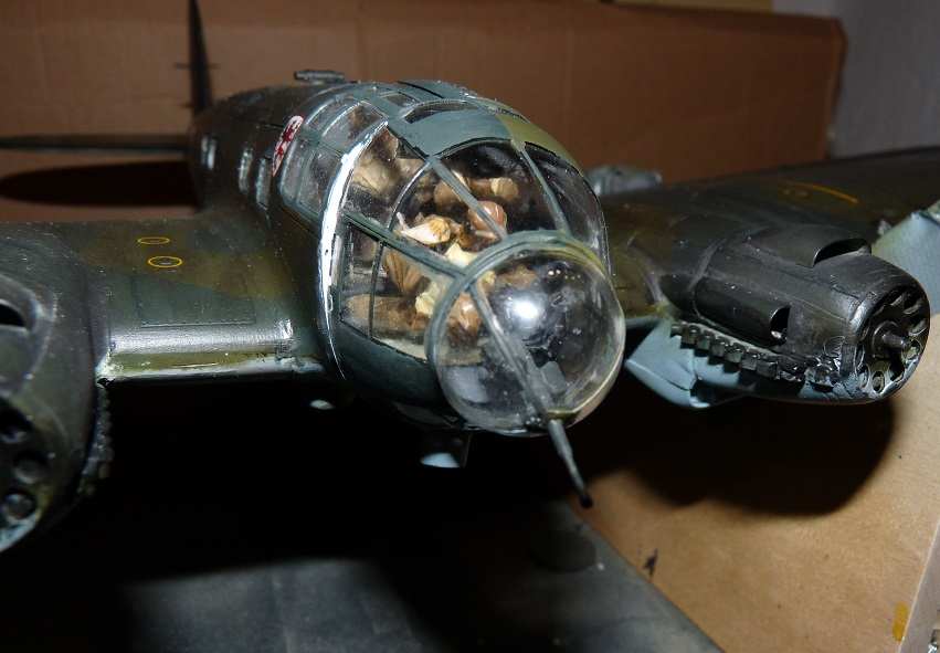

Not much progress these days, but time-robbing detail painting. I don´t know how I missed that but there are some striking gaps between the cockpit and the fuselage. So I had to putty yet again, aargh!
#119
It is what it is.
Semper Fi.
Manny
