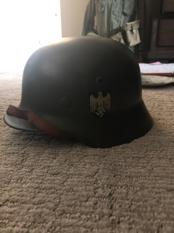

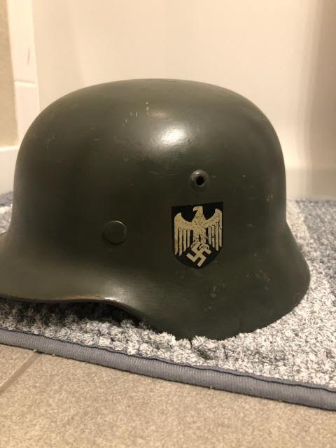

Hello! I have what looks to be a German m35 helmet. I know the shell and possibly the liner are original, but I want to take steps into figuring out if the decals are original. How would I be able to do this and are there any visible sings of them being reproduction from the photos?
Solved by Jim McCauley
Those photos are horrible and that can be a red flag. The liner looks in worse condition than the shell. To determine the decals requires straight on pictures with the proper light.

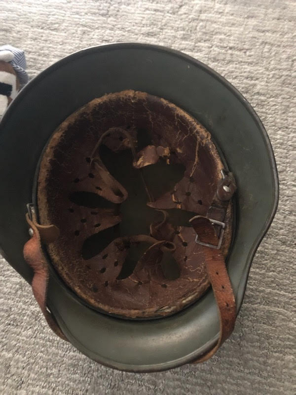

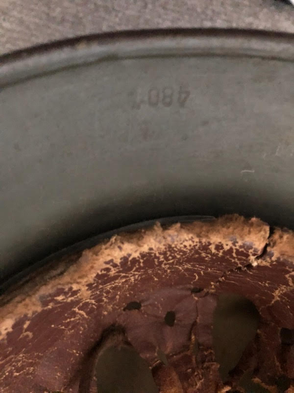

Apologies, here you go.
Original shell.  Post-war paint and decals. Norwegian, re-dyed, liner. Norwegian chin strap.
These helmets were Norwegian surplus in the 1970s.  Sellers would repaint them and put reproduction decals on them.

I'm not sure if I'm understanding your question properly. The liner is a Norwegian reissue due to the red dye job.  I'm not sure why these Norwegian refurbished liners received the dye, but it does appear on most, but not all, reissued German liners. Some people have had success removing the dye with acetone, but it never worked well for me.  I've tried it twice.
It is a nice complete example. I really haven't followed the value of these. Maybe $300 isn't too bad for a dealer price. From a friend, I would expect $150-$200 but that's just a guess on my part.
If I was going to lay out $300 for a helmet, I would try to find an all-original WWII German, no decal, M40 or M42.  With some shopping and a little luck, they can be found in the $300-$350 price range.
